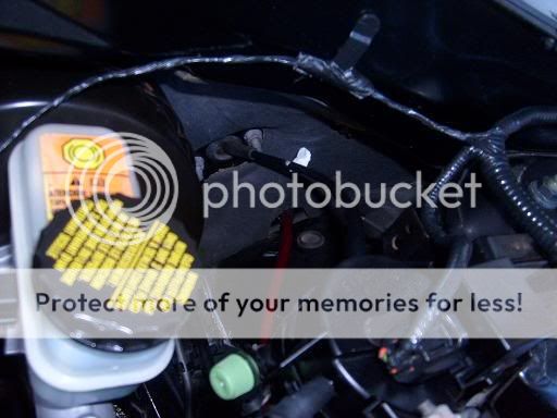

(engine side)
(the hood release cable is under the power wire in this pic. I zip tied them both together)

(engine side)
