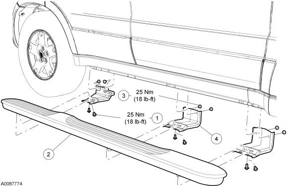

Removal:
1) For each side, remove six bolts attached to the board. Two bolts are under each of the three brackets.
2) Remove the board.
3) Each bracket is secured to the frame rail with two bolts. Remove these bolts.
To install, reverse the installation procedure.
