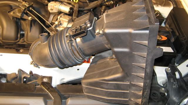

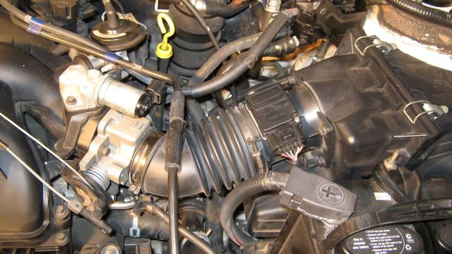

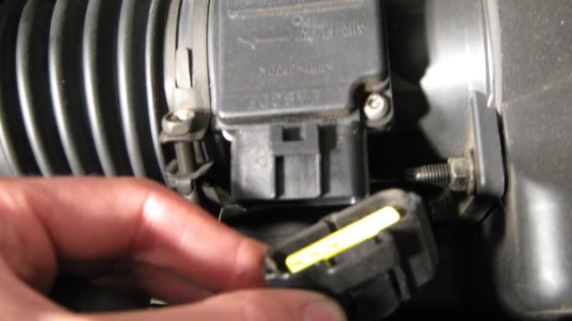

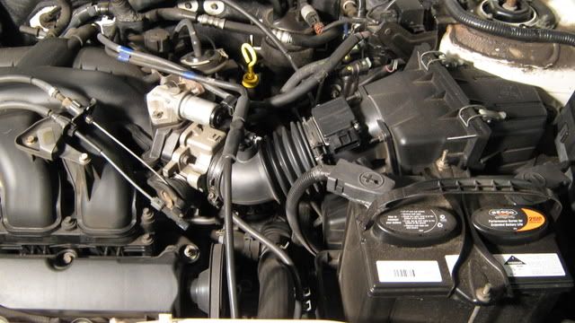

1. Detach air intake hose which connects to the throttle body

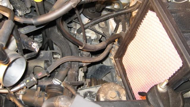

2. Unclip hooks on top of air filter housing
3. Disconnect electrical plug that connects to the MAF
4. Remove intake hose, MAF and air filter housing unit

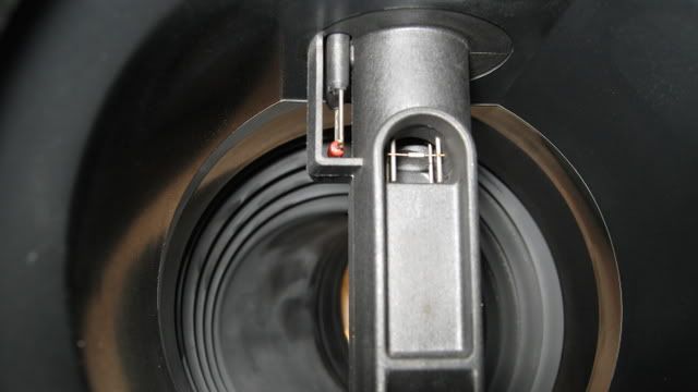

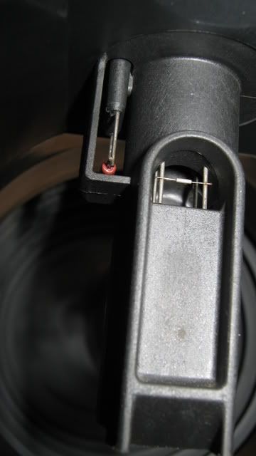

5. Inspect condition of electrical contacts inside the intake hose

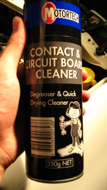

6. Spray the electrical contacts liberally with Electrical Contact Cleaner
7. Reassemble
Hope this helps someone out :thumb:
