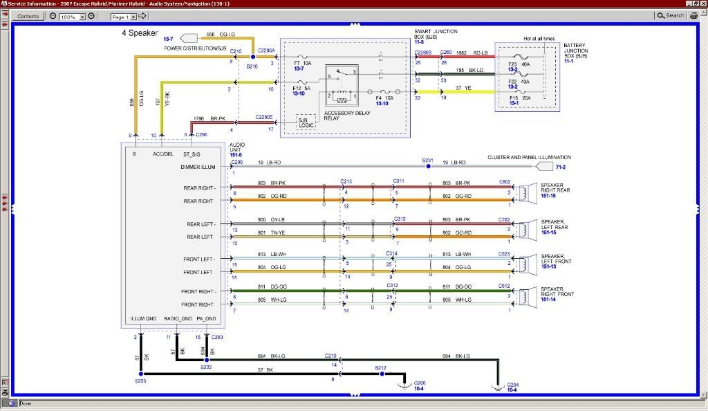

2005-2007 Escape/Mariner Hybrid 4-speaker factory audio system:

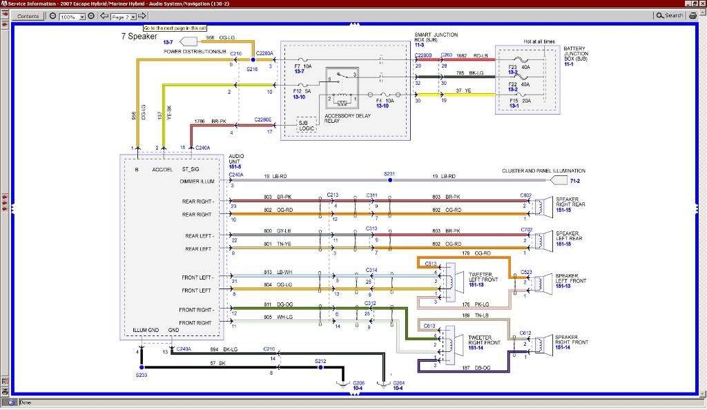

2005-2007 Escape/Mariner Hybrid 7-speaker factory audio system:

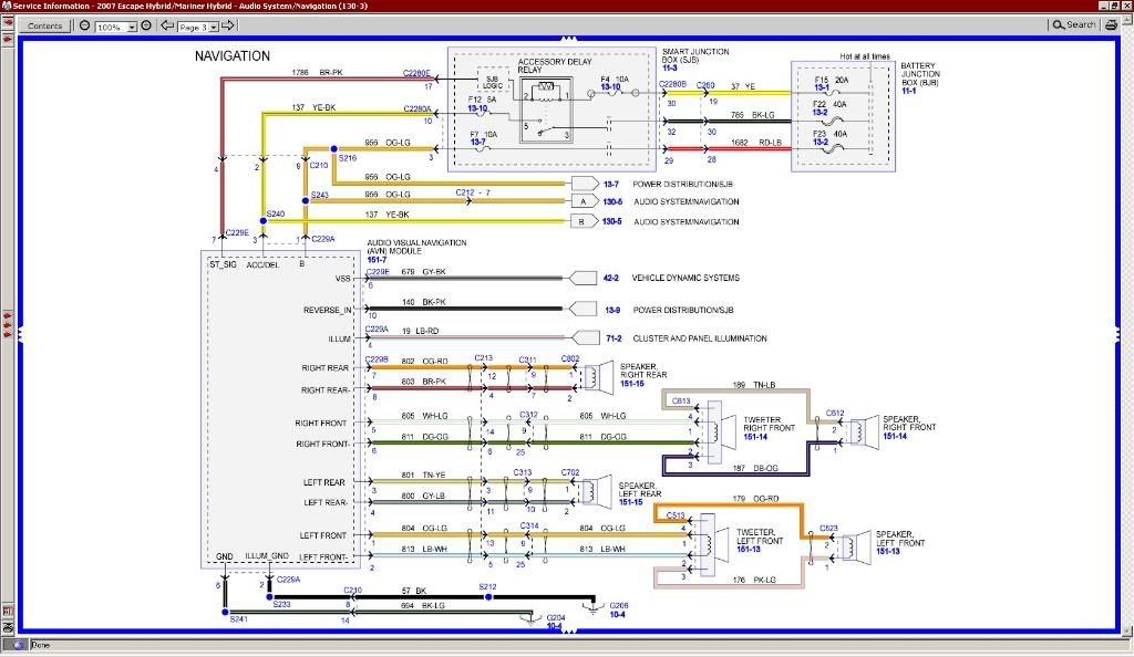

2005-2007 Escape/Mariner Hybrid 7-speaker factory audio system with navigation:

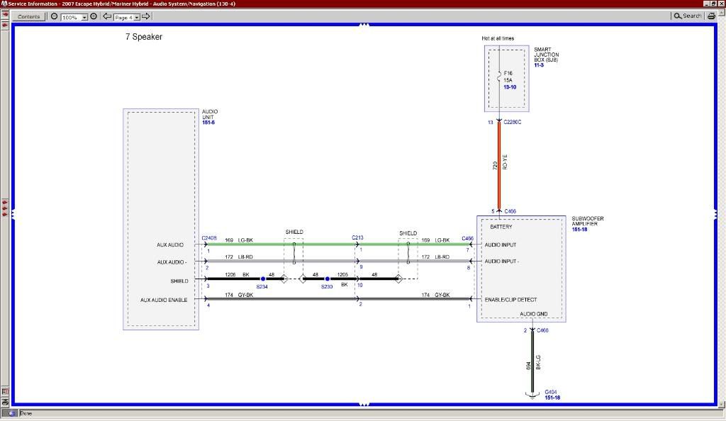

2005-2007 Escape/Mariner Hybrid 7-speaker factory subwoofer:

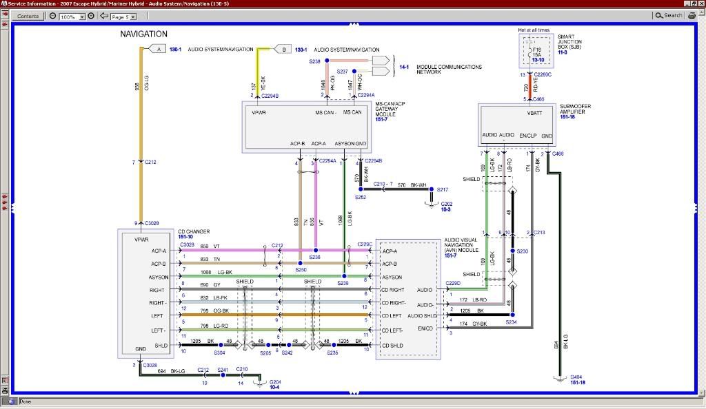

2005-2007 Escape/Mariner Hybrid navigation components:
