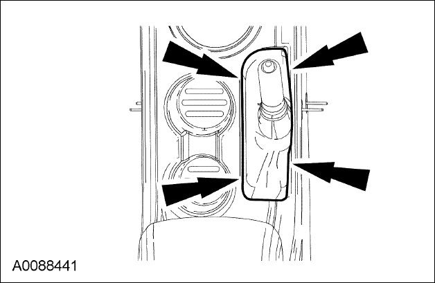

1) Release the parking brake control boot clips at the floor console by pressing inward on the base of the boot.
* Pull the parking brake control boot up and over the lever.

The boot removal diagram is misleading. Only the back two have locking tabs/clips. The front ones are just guides, so pressing them has no effect. What keeps the front down is a tab that hooks under the console, so the boot must be removed BACK TO FRONT. The release on the back two is a bit of a challenge, but they are the only ones that affect the release.
