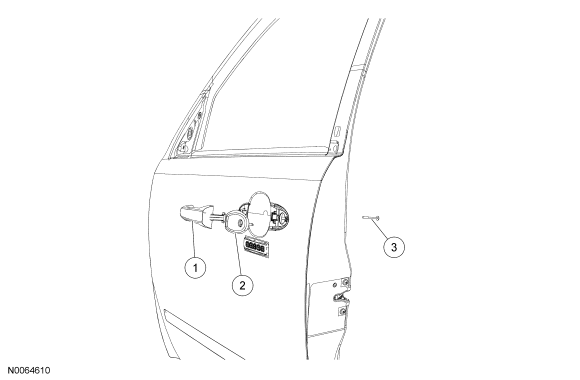

Item - Part Number - Description
1 - 7822404 - Exterior front door handle
2 - 78218B08 / 78218A14 - Exterior front door handle cover (RH, LH/ with lock cylinder)
3 - Exterior front door handle cover retaining screw (part of 7826684 / 7826685)
Removal and Installation
1) Remove the front door trim panel. See viewtopic.php?f=27&t=875
2) Position the watershield aside.
3) Remove the exterior front door handle cover retaining screw from the door handle reinforcement .
4) Remove the exterior front door handle cover.
* Pull the exterior front door handle open.
* Pivot the rear of the exterior front door handle cover and remove.
5) Remove the exterior front door handle.
* Open and pull the exterior front door handle rearward to release and remove.
6) If necessary, remove the exterior front door handle seals.
7) To install, reverse the removal procedure.
