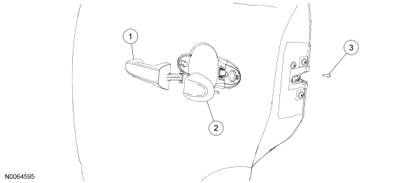

Item - Part Number - Description
1 - 7822404 - Exterior rear door handle
2 - 78218B08 - Exterior rear door handle cover
3 - Exterior rear door handle cover retaining screw (part of 7826604 / 7826605)
Removal and Installation
1) Remove the rear door trim panel. See viewtopic.php?f=27&t=876
2) Position the watershield aside.
3) Remove the window channel bolt and position the window channel aside.
* To install, tighten to 8 Nm (71 lb-in).
4) Remove the exterior rear door handle cover retaining screw from the door handle reinforcement.
5) Remove the exterior rear door handle cover.
* Pull the exterior rear door handle open.
* Pivot the rear of the exterior rear door handle cover and remove.
6) Remove the exterior rear door handle.
* Open and pull the exterior rear door handle rearward to release and remove.
7) To install, reverse the removal procedure.
