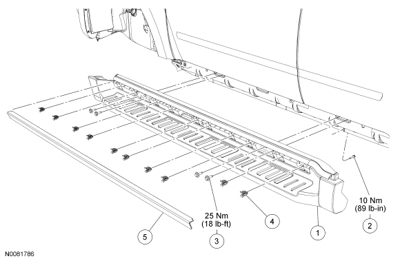

Factory step bars are available as a Ford Accessory, part number 8L8Z-16450-AB, which includes all hardware.
How to remove the factory rocker panels
The following parts are required, and are included in the accessory step bar kit:
1 - 16451 - Running board
2 - N808328 - Body-to-running board bracket screw
3 - W701834 - Running board bolts (4 required)
4 - Push clips
5 - 16C469 - Running board trim bezel
Removal and Installation
1) With the vehicle in NEUTRAL, position it on a hoist. For additional information, refer to Section 100-02 .
2) Release the running board trim bezel push clips and remove the running board trim bezel.
3) Remove the 4 running board bolts and remove the running board.
* To install, tighten to 25 Nm (18 lb-ft).
4) Remove the body-to-running board bracket screw.
*To install, tighten to 10 Nm (89 lb-in).
5) To install, reverse the removal procedure.
