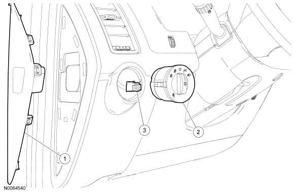

1) Remove the instrument panel side finish panel.
2) NOTE: The headlamp switch is removed by pushing from behind.
* Squeeze the tabs and remove the headlamp switch.
* Disconnect the electrical connectors.
3) To install, reverse the removal procedure.
