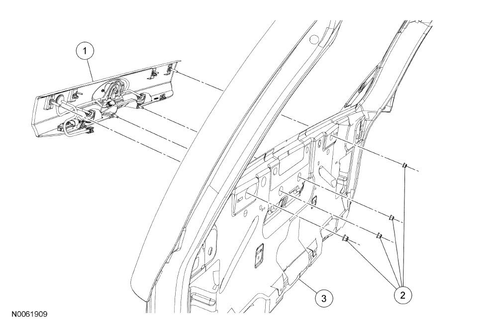

Removal and installation
1) Remove the liftgate trim panel.
2) Disconnect the license plate housing electrical connector.
3) Remove the license plate housing retaining nuts (4 required).
4) Release the license plate housing from the push clips and remove the license plate housing from the liftgate.
5) To install, reverse the removal procedure.
