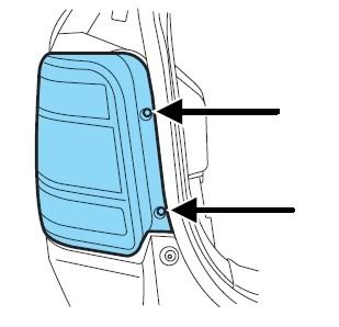

NOTE: The tail/stop/turn/sidemarker/backup lamp bulbs are located in the same portion of the tail lamp assembly, one just below the other. Follow the same steps to replace either bulb.
1) Make sure the headlamp switch is in the OFF position and then open the liftgate to expose the lamp assembly screws.
2) Remove the two screws from the lamp assembly.
3) Carefully remove the lamp assembly away from the vehicle by pulling the assembly straight back and out to expose the bulb socket.
NOTE: DO NOT TIP THE LAMP ASSEMBLY SIDEWAYS.
4) Rotate the bulb socket counterclockwise and remove from lamp assembly.
5) Pull bulb straight out of socket and push in the new bulb.
6) Install the bulb socket into the lamp assembly and rotate clockwise.
7) Carefully install the tail lamp assembly on the vehicle and secure with two screws.
