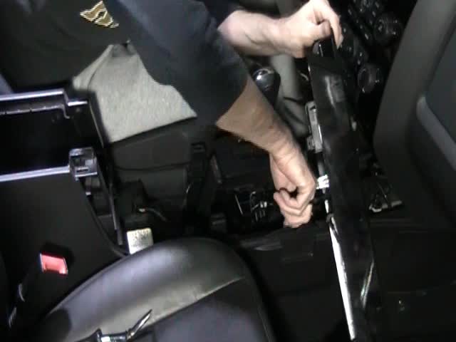

Trim ring around the gear shift on my brand new Escape Ltd. was scratched at dealership today while being serviced, and I'd rather replace the piece myself than take it back to the dealer. Is a specialty tool required to remove the trim ring, or does it simply pop in/out of the console? Seems like a pretty tight fit and I don't want to force it.
It just pops out. Just wrap a small flathead screwdriver with tape and stick it under the edge of the ring.
This is me taking mine out...
