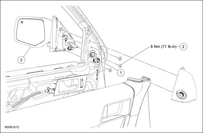

1) Remove the front door trim panel. See viewtopic.php?f=28&t=875&p=70349&hilit=door#p20218.
2) Disconnect the exterior mirror electrical connector.
3) Remove the 3 bolts and the exterior mirror.
* To install, tighten to 8 Nm (71 lb-in).
4) To install, reverse the removal procedure.
