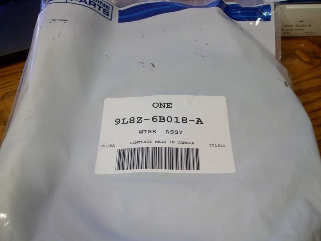

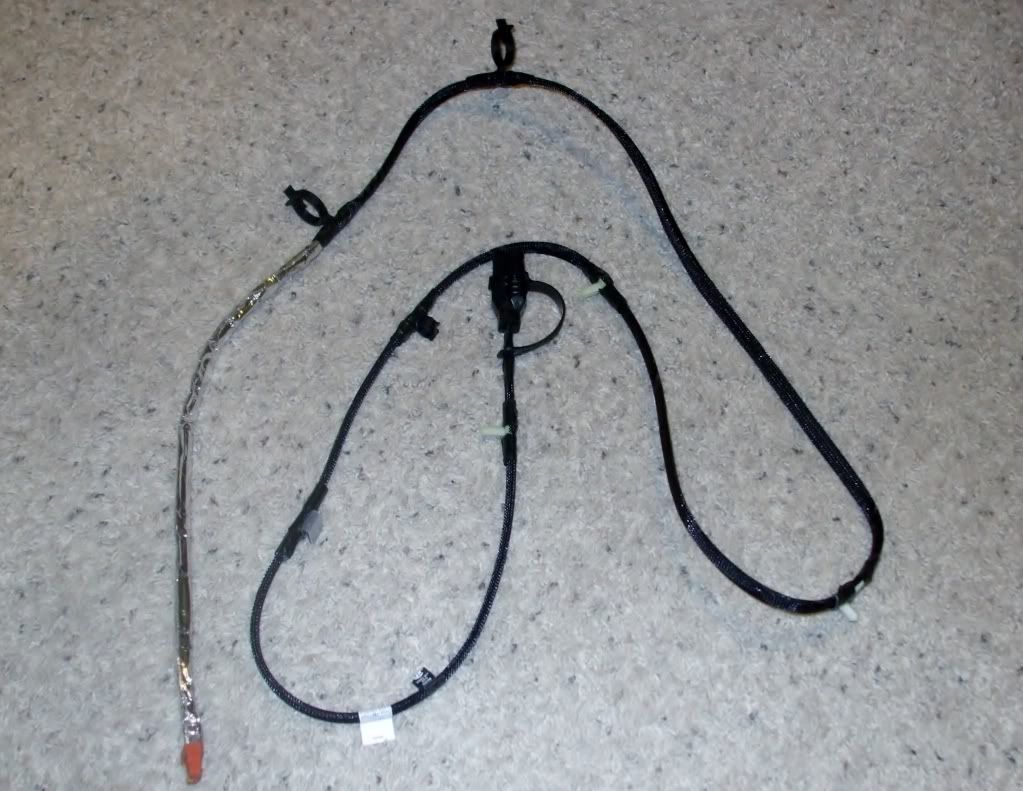

Here's the cord package:
Here's the cord laid out on my floor:

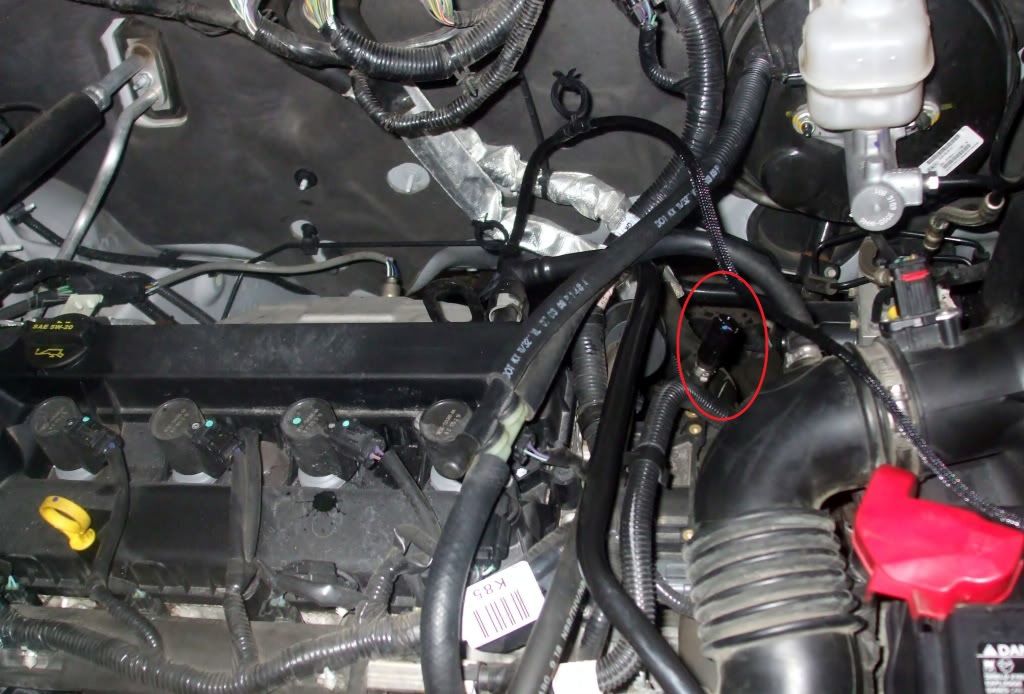

Step 2: Find the freeze plug to remove. Here is a pic of my engine with the general area you need to be looking:
The freeze plug to remove is located underneath the exhaust manifold on the driver's side. It is actually easiest to just go in through the top (that's what she said

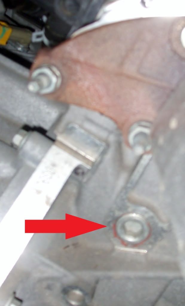

I had some trouble getting a picture of the plug with my camera, so this image is slightly crooked, but you're basically looking at the back side of my engine block. The brown thing at the top of the pic is the flange of the exhaust manifold. As you can see, the freeze plug requires a 14mm hex bit socket to remove:

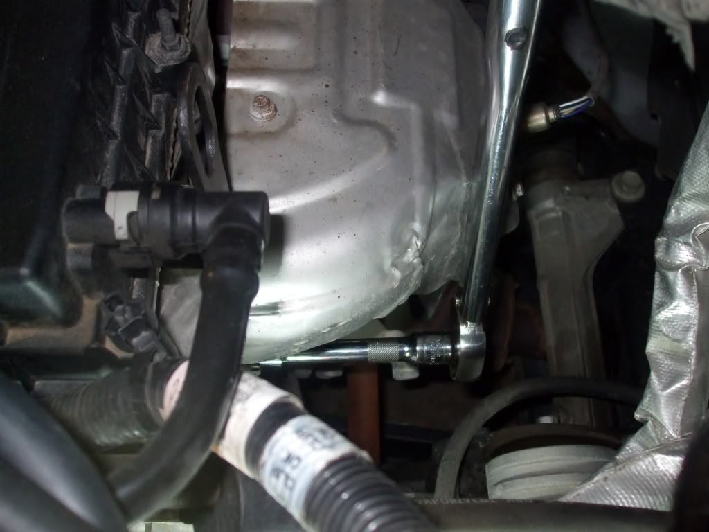

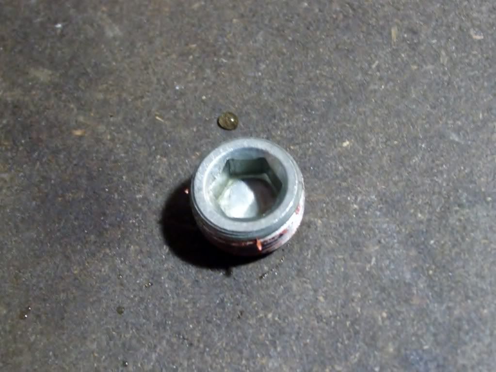

Step 3: Get your ratchet, socket, and extension, and remove the freeze plug. You can actually get the socket down in from the top fairly easily. The turning of the ratchet is a little restricted, but it shouldn't take more than a minute or so to remove the freeze plug. Since I used an old torque wrench to remove the plug, I did not require a cheater bar. CAUTION: If you have not yet drained your coolant, it is going to come out now. I put a clean pan underneath my car to catch and reuse the coolant:
Here is a pic of the freeze plug once it's removed:

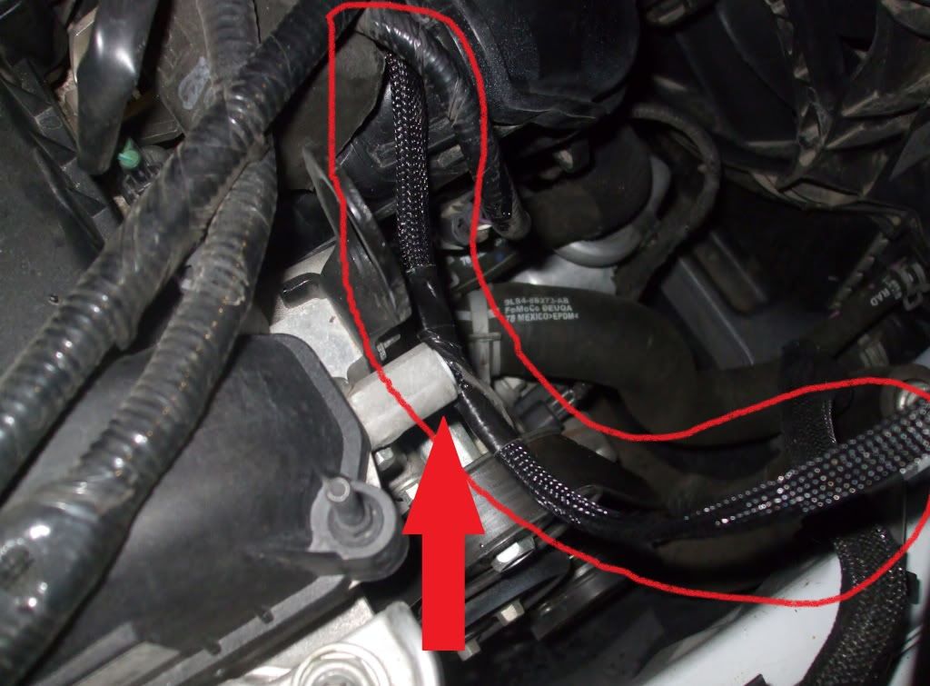

Step 6: Route the heater cord. If you have not done so yet, plug the heater cord into the heater element. I wasn't really sure how to route the cord, so I'll just show you what I did. Here's a few pics:

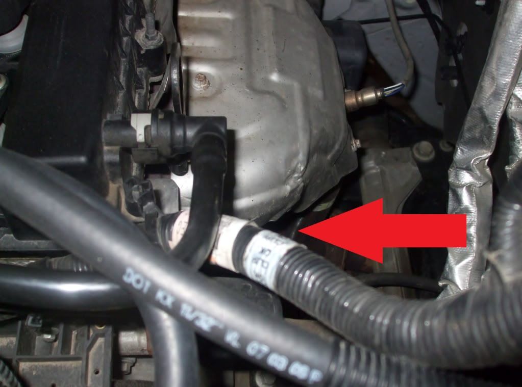

Note that I took it straight up and past the valve cover on the driver's side, and then hung a right turn towards the opposite side of the car, across the intake manifold runners. The arrow in the next pic shows a hole in the block that seemed to accept the plastic holder clip on the cord quite nicely:
Although the cord looks very close to the serpentine belt, there is a good 2 inches of clearance.

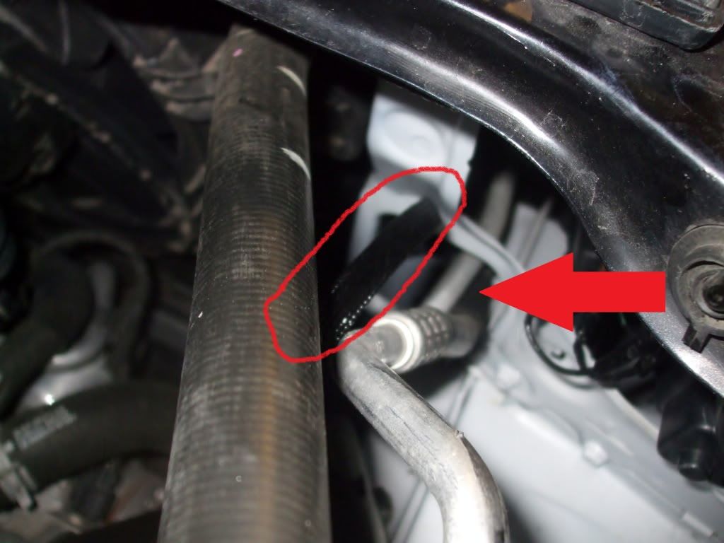

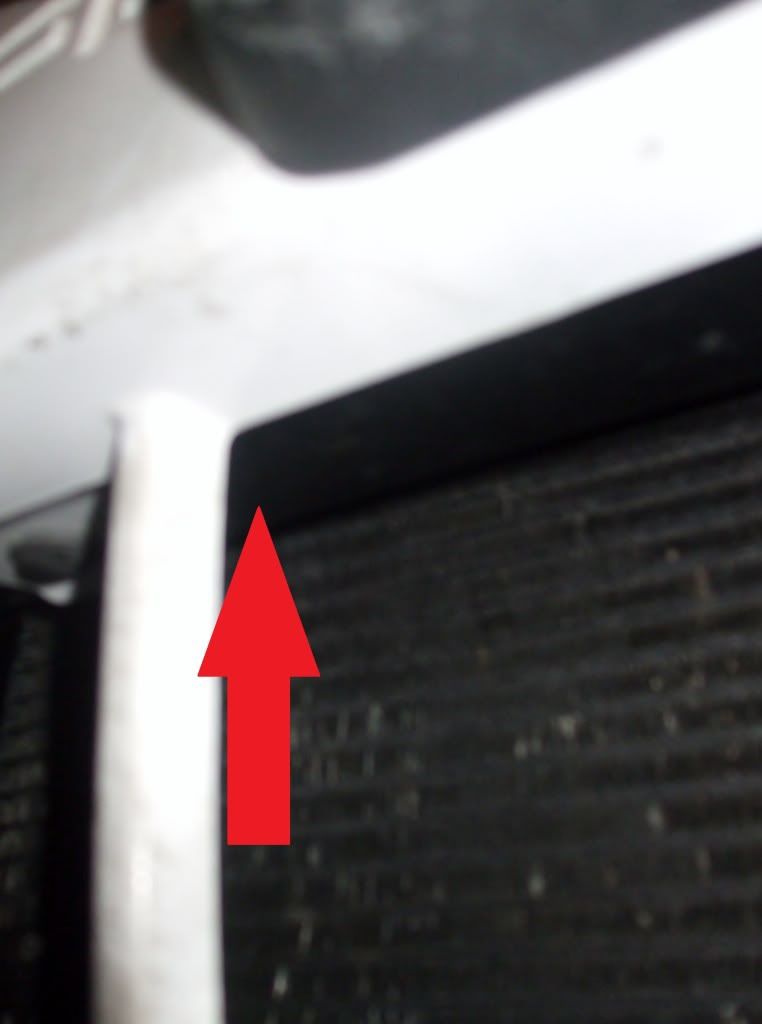

I then took the cord around and put it through a hole in the radiator support near the A/C fan. It is right next to the (high pressure?) A/C line:
Once the cord goes through this hole, you can grab it through the bottom hole in the front bumper. The next pic shows the approximate location where I used the clip on the cord to attach it to the metallic support behind the bumper cover:

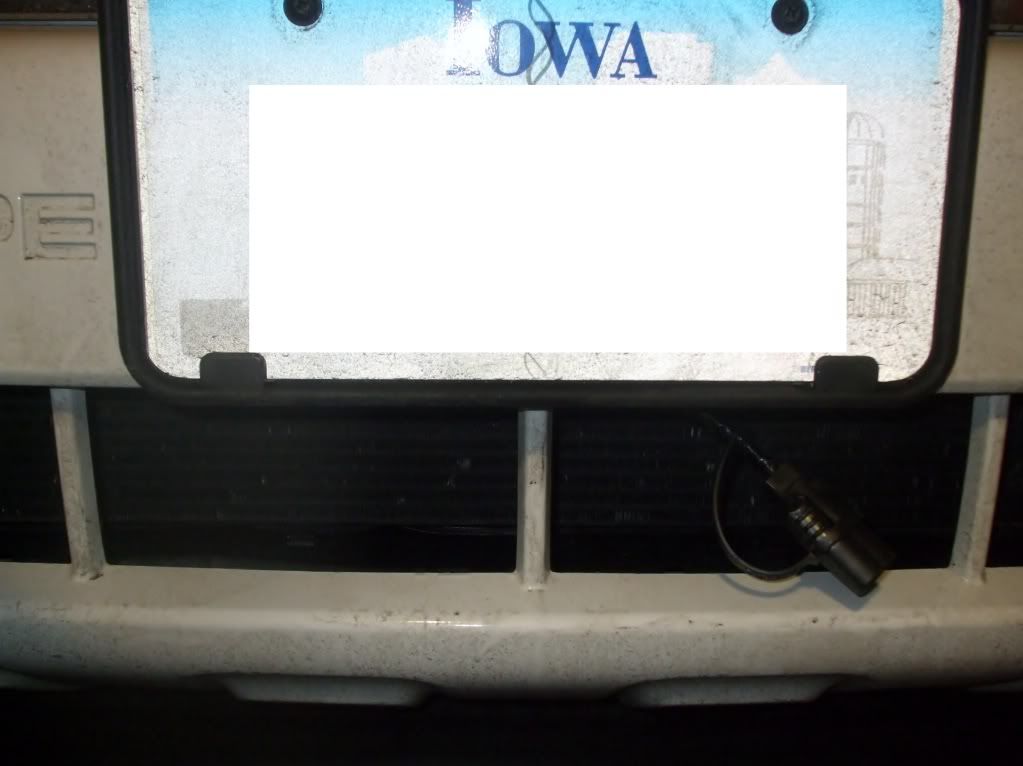

Finally, I stuck the last plastic clip holder on the cord into the hole on the bottom of the license plate support, which allows the cord to be held in place as pictured:
