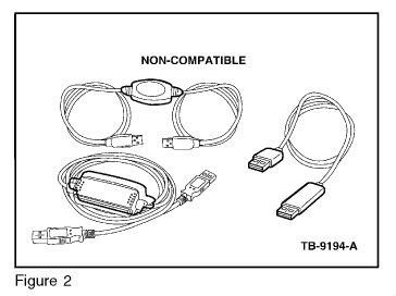

4. Connect one end of the USB male-A to male-A cable Rotunda part number CCMUSB2-AM-AM-10 (1-800-Rotunda option 6) or equivalent to the scan tool. Compatible cables. (Figures 1) Non-compatible cables. (Figure 2)
5. Connect the other end of the USB male-A to male-A cable to the vehicle USB port.
