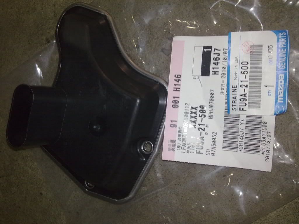

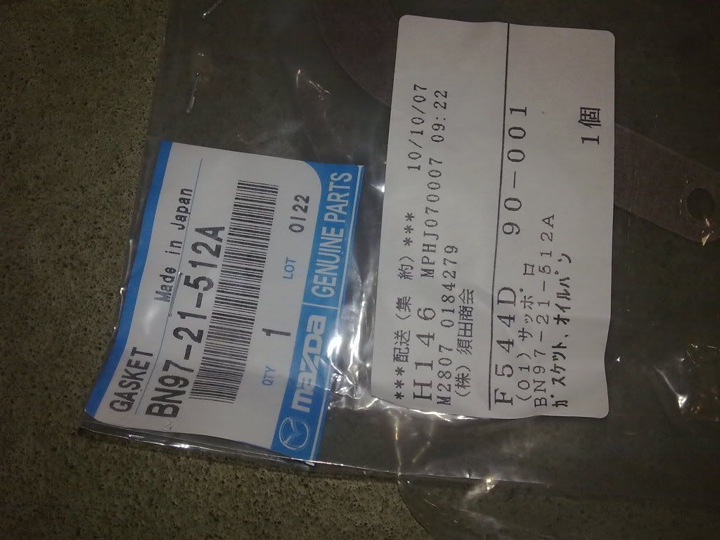

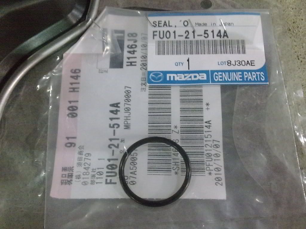

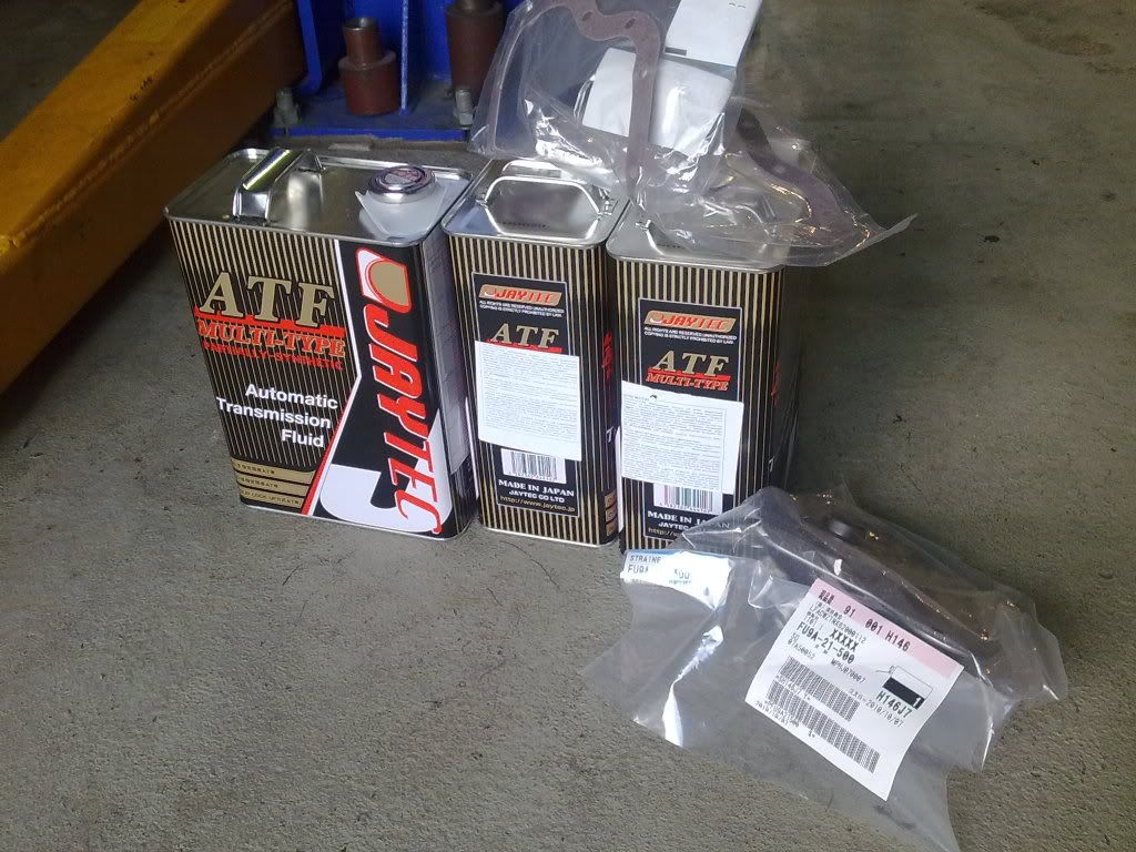

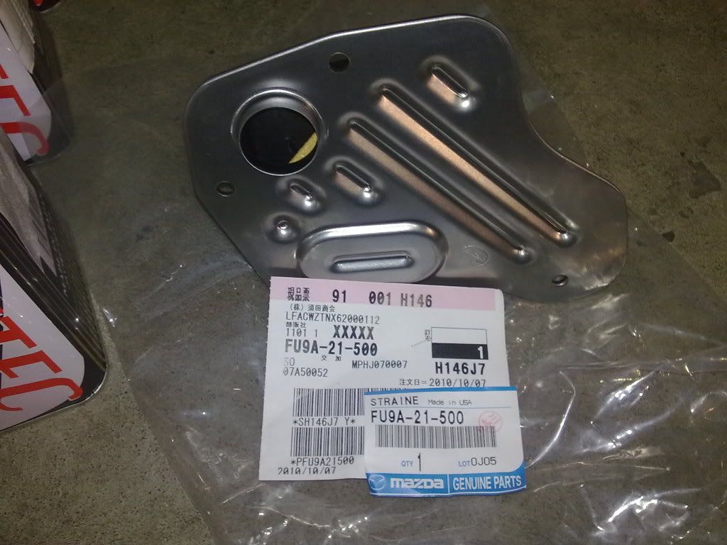

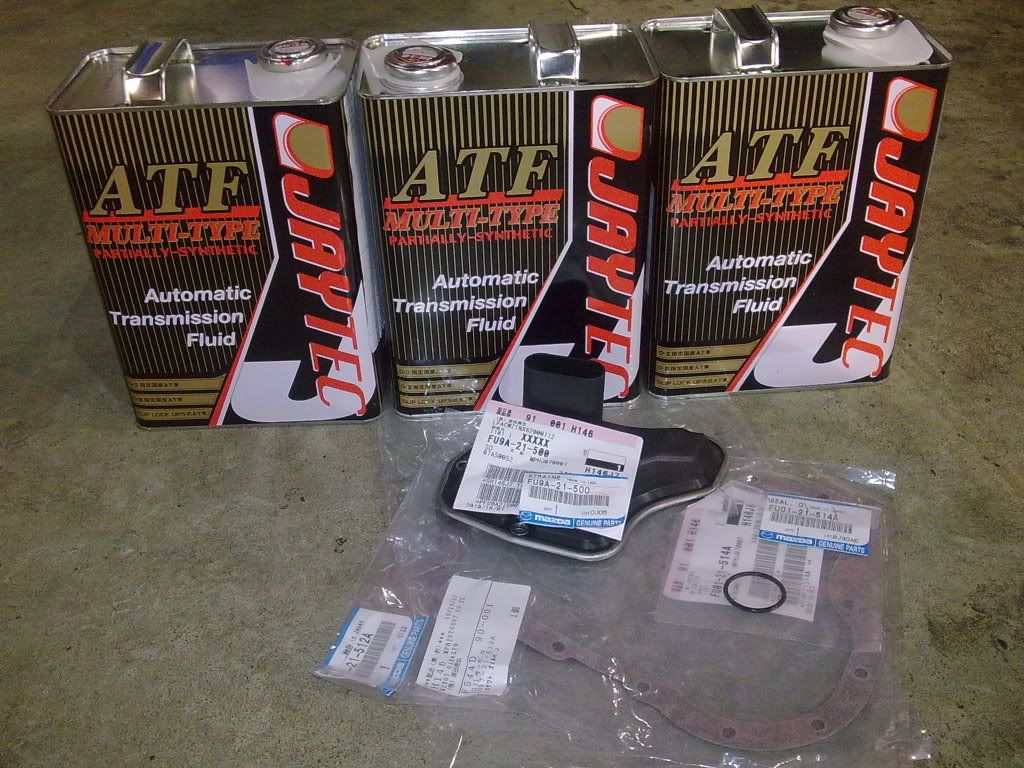

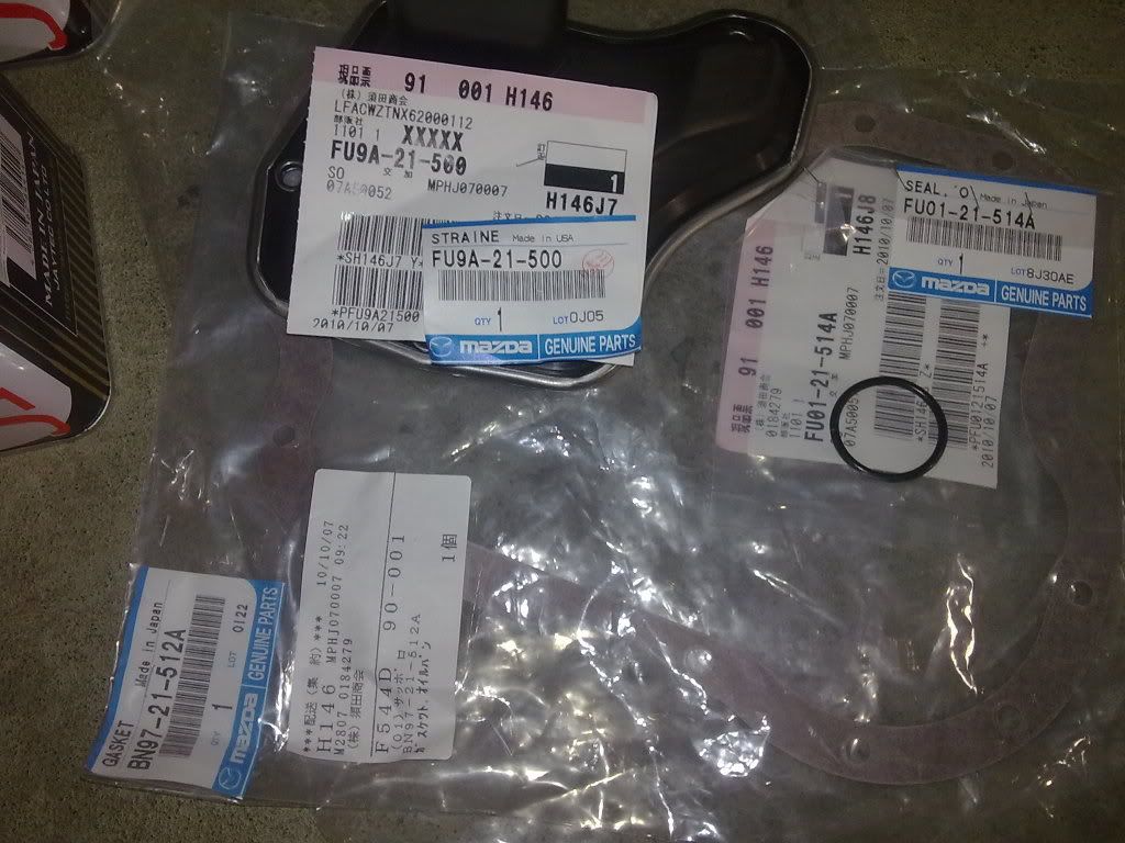

i bought 3 cans of Jaytec ATF, filter, rubberband, rubbercircle from Japan Yahoo.co.jp
cause i got 100k kilometers total it's time to change
here are some pics:
fluids filter etc.

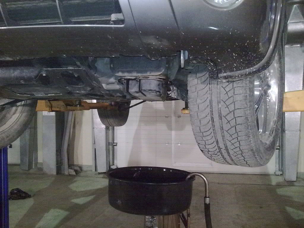

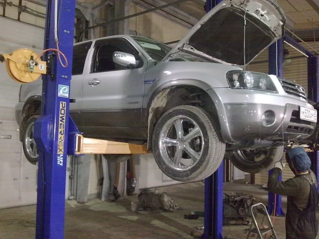

that's my boy on the lift looks like uppered up

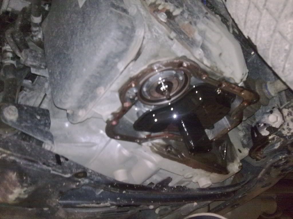

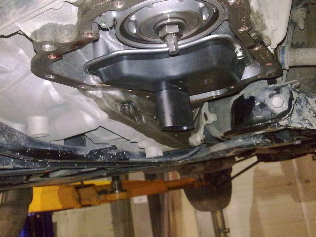

unplug the lower tray - 20 bolts
dispouse the old fluid than pressure it up through the machine
that's how it looks the old one
yeah baby! the new one
yep it's installed
