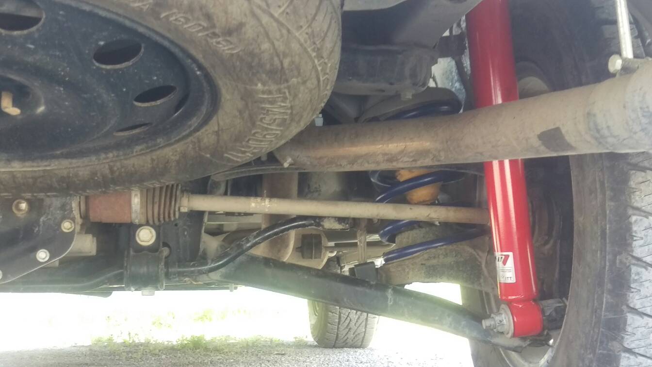

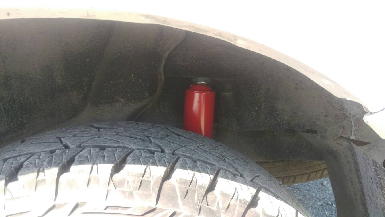

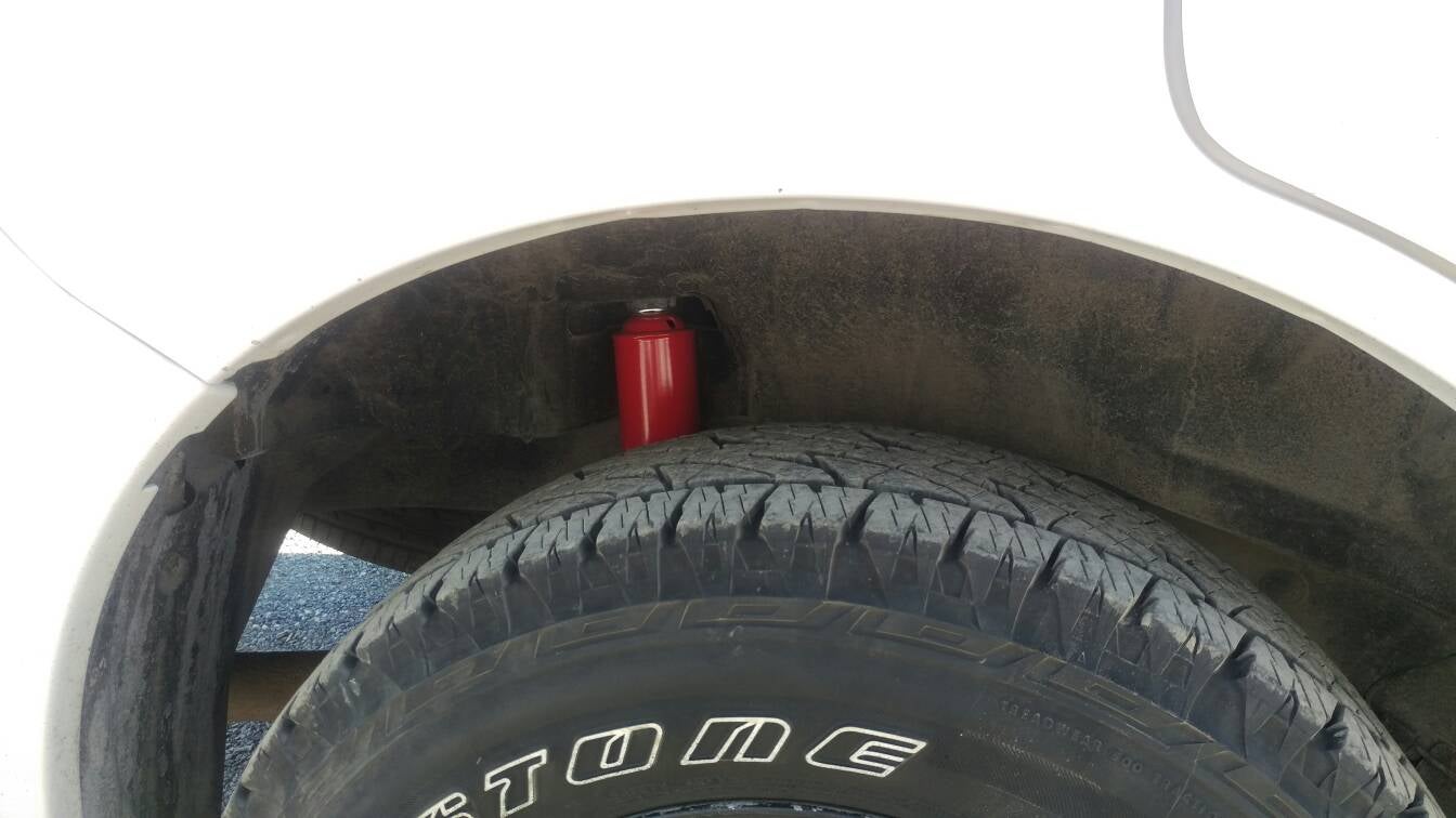

Will the Konis fit as a direct replacement or will you have to modify?
They're a direct fit. It's a huge wait time to get them from anywhere.
KONI shocks and and HR springs in the rear.
Spot weld on the Gibson exhaust. The shop and I talked about how much damage I do to this poor system (2 or 3 repairs in one summer) so we agreed to weld two sections.
How are the H&R springs holding up?
Beautifully.
