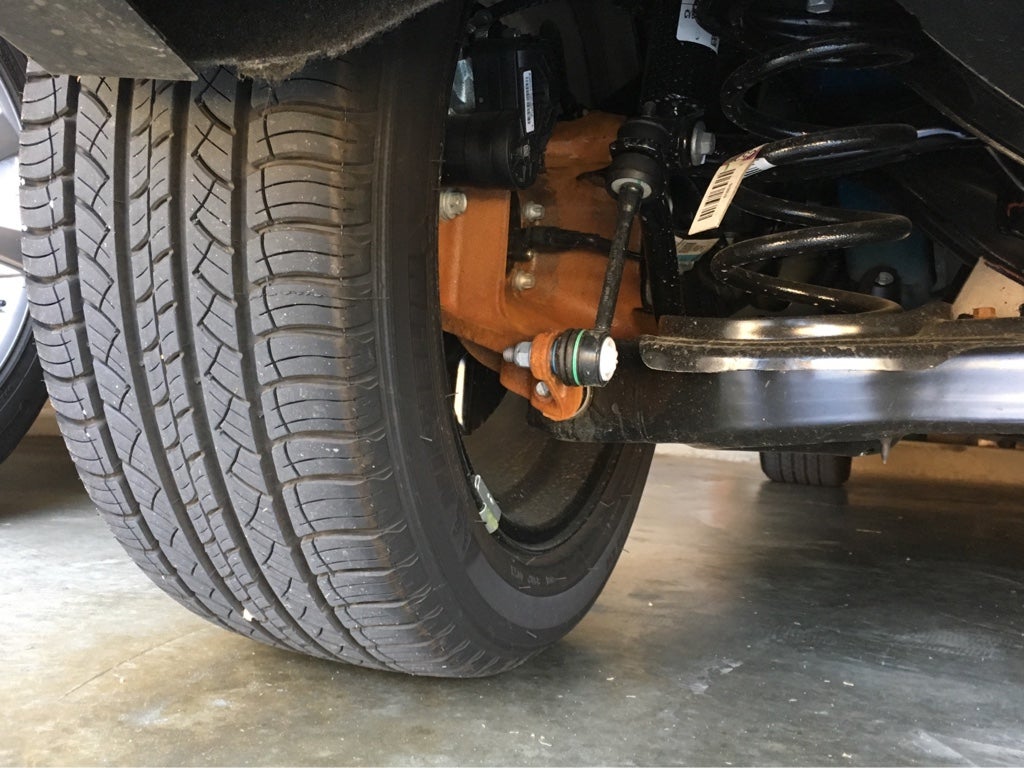

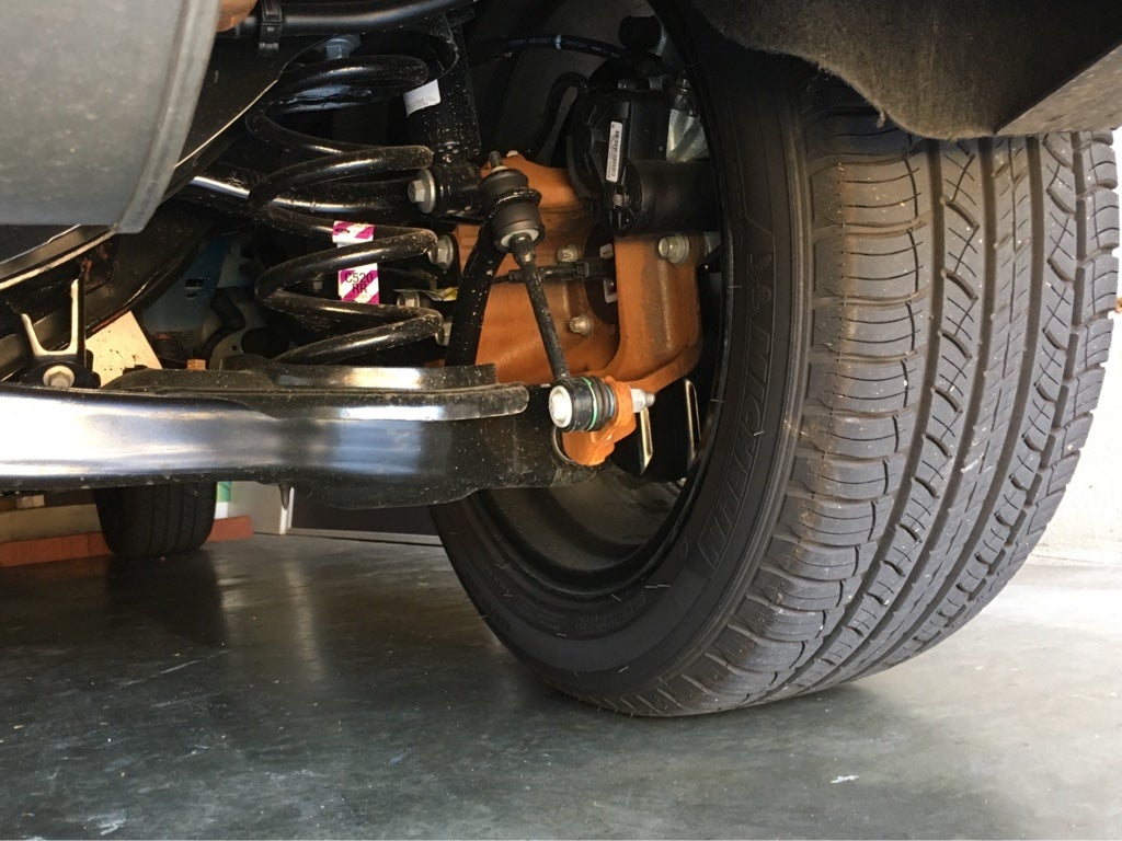

I bought a brand new 2017 Ford Escape exactly one week ago. I was looking under the car yesterday, and saw what looks like extensive corrosion inside the rear wheels. Can the experts please comment? Do I need to take this in?

That's normal.
Certain parts get surface corrosion that prevents any additional corrosion from penetrating the part.
This type of corrosion is typical of suspension and frame components like control arms, frame bits, differentials, tie rods, and steering knuckles (what you're looking at).

THats a front wheel drive, I wonder how popular the AWD will be or if they getting away from that.
Like mentioned, thats normal, thats a cast piece which will start rusting immediately after its made. It will probably last 100 years though lol. They could have coated or painted it, but they obviously didnt think it was important.
You can paint them, but that involves a fair bit of work if you want to do a good job, the easiest thing is to remove it and paint it, but you can still try to do it with a can of spray paint and try not to spray over anything important like an ABS sensor or something.
You could also touch up any other small rust spot while you are under there, looks like a couple small spots are already starting. Do it now before they get out of hand.
