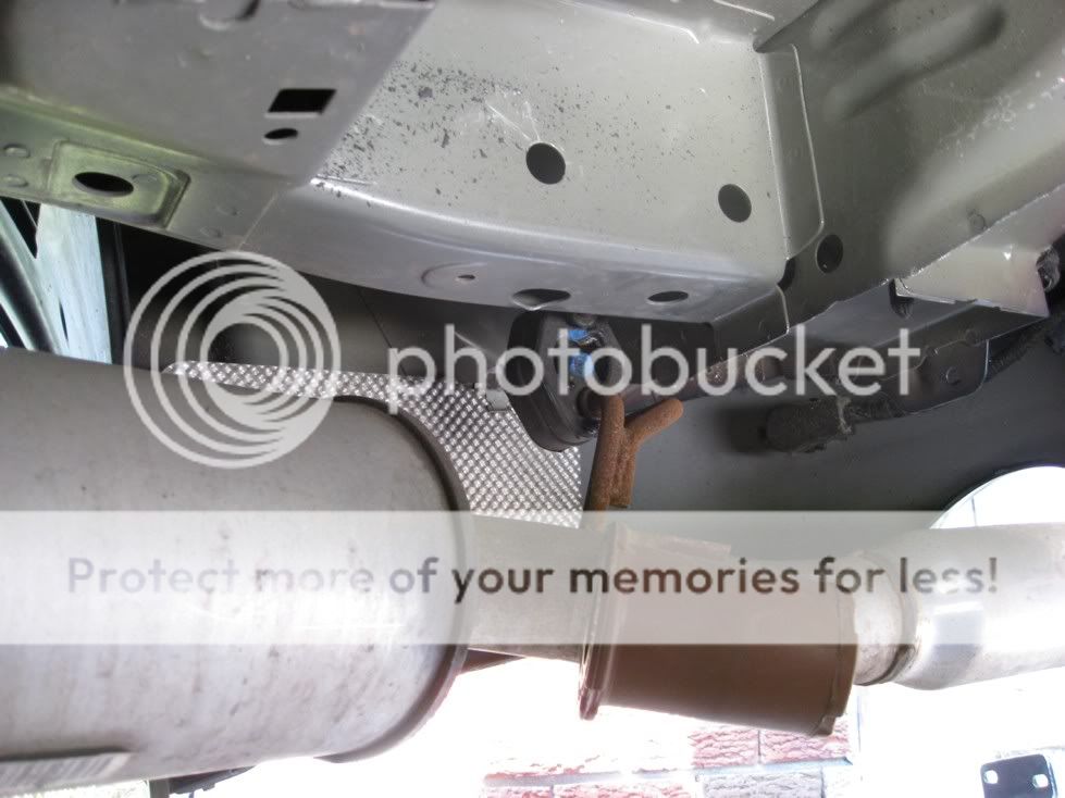

I tried installing a Draw Tite hitch on my 2010 Mariner V6, but ran into a problem.
There is a canister of some sort welded onto the tail pipe, that is interfering with the hitch.
Does anyone know what that part is? It's not connected to anything, no wire or tube. It is just in the way.
I have emailed etrailer, where I bought the hitch, but haven't heard back yet.
Has anyone successfully installed a hitch with that canister there? If so, what brand and model?
Thanks.
That cannister, to the best of my knowledge is just to keep the tailpipe from vibrating. So that would make it a dampener.

That's what etrailer found out and told me. They say it was just added this year, and Draw-Tite didn't know until recently.
They suggested moving the exhaust, but that's not something I want or know how to do.
I guess I'll be returning the hitch until they redesign it.
Would you be up to taking that baffle out? Cause I am sure there wont be a redesign for that issue.
57 Posts
I can cut it off, Dremel with a cutoff disc.
I'm just worried about the consequences. I wonder how bad the vibration was that Ford added that contraption.

836 Posts
Is that deadener a V6 thing? My 2010 Escape I4 does not have that. My hitch would not have worked either. But mine is a Hidden Hitch that hangs down just under the bumper so no cutting was needed. Not sure about yours.
How much can that gizmo really add to quieting?
57 Posts
The hitch I bought was a Draw Tite, same as the Hidden Hitch. It hangs below the bumper
Apparently, from what you're saying, the I4 doesn't have that dampener. Mine is a V6.
The OEM Ford hitch goes through the bumper, you have to cut out a portion of the bumper cover to install it. Cutting is not a problem, it's only plastic. I'm not sure what it will look like, you'd have make make a neat cut.
836 Posts
Nope. No gizmo on mine. Not sure if it is a V6 thing or a Mercury difference from Ford.
Space out the rack. If it will fit past the gizmo, just remove the rear pipe hanger and put the hitch on. Then re-hang the pipe. In looking at it, I think you might be able to get around it.
