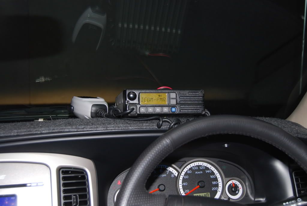

A friend of mine used to own the F2020 that Icom produce for canada and america. He mentioned this high power overseas version ,has all the same adjustable parameters within its " Dealer set mode" as my F2010 has. On these models directly under the radio screen, there are programmable assign keys. There are four buttons specifically designated as [PO] [P1] [P2] [P3]. The last two buttons are channel up and down keys. Obviously they will be clearly designated as such with up and down arrows.

The user password is only four digits. But the dealer ( set mode) passcode must be entered as six digits. The customary ICOM default of " 159357" can be used. For example on the Icom F2010 or F2020 it would be done as [ P1] [ P0 ] [ Down channel key ] [ P3 ] [ PO ] [ P2 ].
