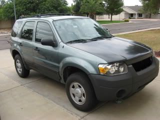

Here's the finished product. The hood is still awaiting paint next week. I'll install the grill after the car comes back from the paint shop. My first collision restoration turned out better than I had anticipated.

Here's the finished product. I picked up the hood from the paint shop last Thursday. After I installed the airbag module, the airbag light remained on. Inspecting the driver's seatbelt buckle, I found that the pretensioner was deployed. Replacing that part made the airbag light finally turn off. Visually, the car has that showroom appearance.
