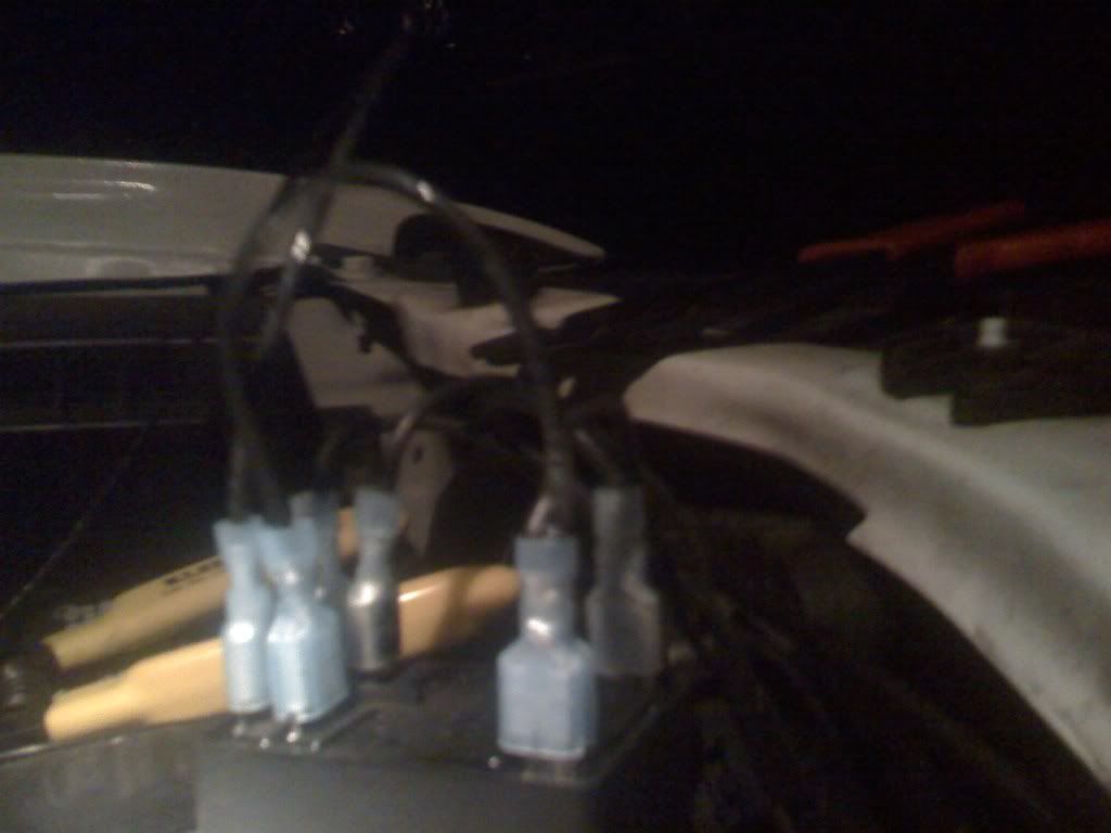

Here is a image of the new relay all hooked up. It worked out great and its very easy to do. Well I have had the 05 headlights for over two years now but with the old set up. lol so for me it was pretty much just running a wire from the highbeam indicator and switching to the new relay. Thanks Jpark!!! You have helped me out a whole bunch.
This is the relay.
This is the connector with the LG/BK wire. Its the LG/BK wire thats furthest to the left in my picture. Its 4 pins from the left of the connector.
