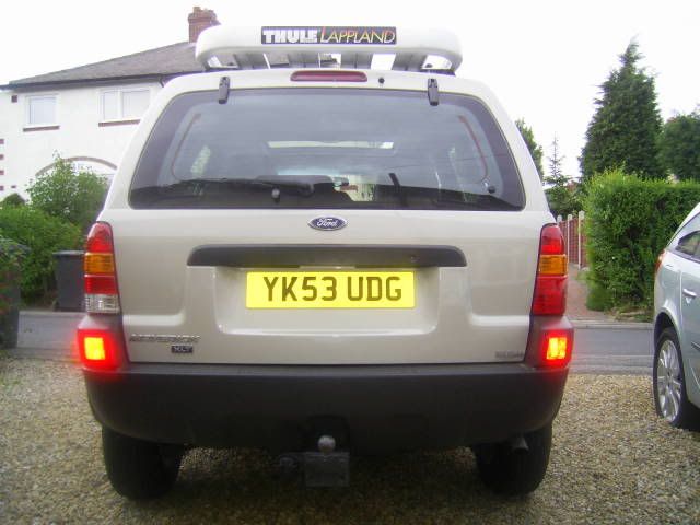

How the Maverick looked at the rear...

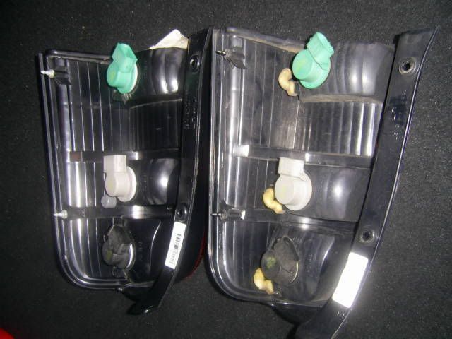

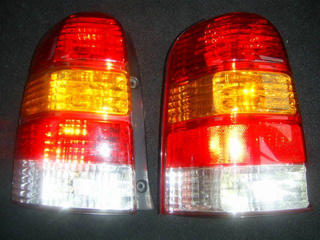

L/H rear lights, the G.B. version is on the left.

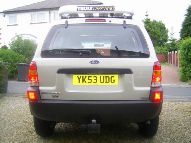

Rear view, again, the G.B. version is on the right.

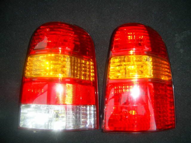

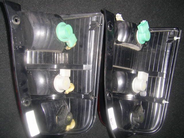

R/H rear lights, the G.B. version is on the right.
Rear view, again, the G.B. version is on the left.
And how the Maverick looks now, the O/S reverse light has now been wired up ;)
O.k., apart from the rear foglight, the other differences in the clusters are that the American ones have both a rear reflector, and the backing of the tail light housing has been modified to allow a red light to shine at the side of the car, I presume thats to satisfy some Federal law regarding side markers.
Oh, and the housing for the rear fog is 1.5 X the size of all the others, looking at the piccies will make that last staement a lot clearer.
