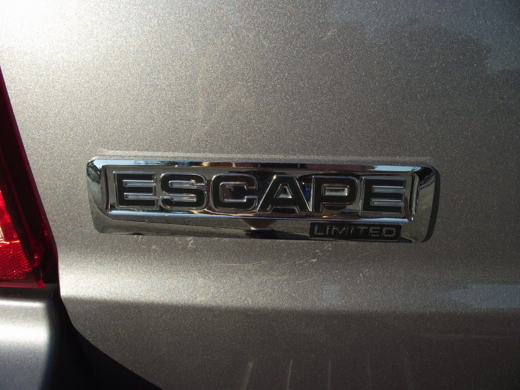

I have some NASTY! Scratches below the Escape decal in the back and i was wondering if there is anything to get them out? and if so can i get this thing at like Advanced auto parts or Auto Zone? Here is a picture.
You can kinda see them there below the decal

A good polish and/or wax. I had scratches on my front left fender from someone driving against it and after about 5-6 polish treatments and 5-6 layers of wax (show wax or scratch wax, take your pick), it's basically gone. I'll be doing the same to the scratches on the right side of my car. I think I'm only on application 3, and the scratches are a little deeper than the ones in my fender.
Good luck. If you need any product recommendations, I can go look at what I have.

I use a high grade polishing compound called Commander, which I got from a buddy at an auto body shop. Amazing stuff! Takes any scratches right out. I use a low speed orbital polisher with a sponge applicator, then wipe off with a clean micro fiber cloth.
