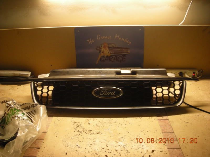

Let the demolition begin!

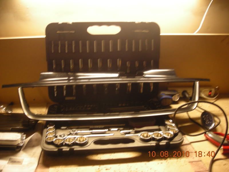

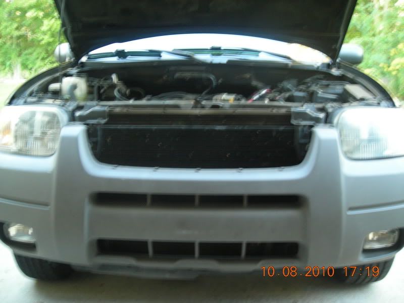

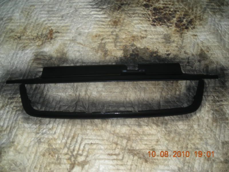

Before I started. You have to cut out the actual grille and insert the new billet grille.

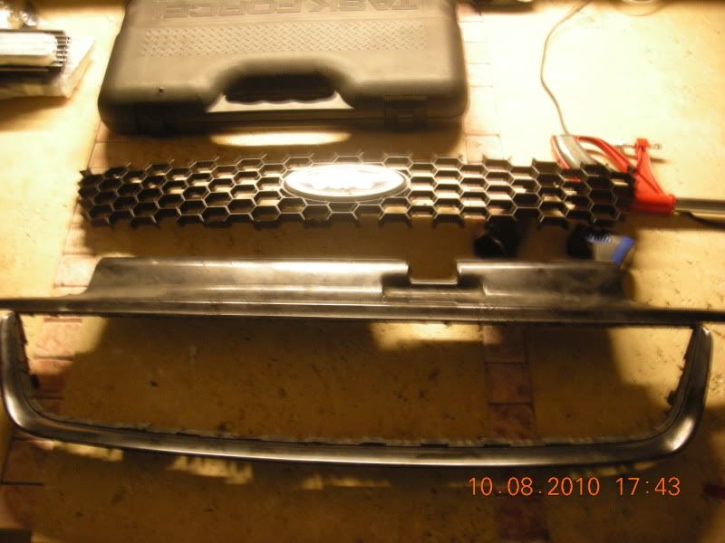

After taking out the grille and started the finish work before paint.
First coat of black.

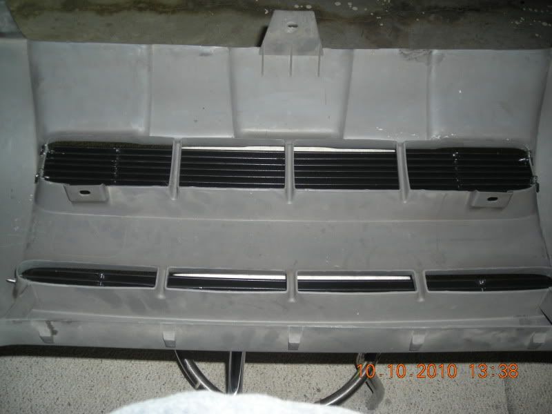

All coats and the clear coats are on! I put 2 coats of black gloss and 2 coats of clear.
Got the 2 bottom grilles in. Those are just drill and bolt on thankfully, though you could take out the stabilizer bars.

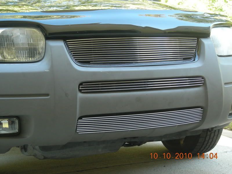

In and installed!!!
All three are in and done! :beer: It was a nice weekend project that really made the front end pop. I can't wait for the Rhino lining and headlights to finish it off.

Actually cutting out the grille was the easiest. I just bought a good hacksaw blade and went to work. It took me about 20 mins to get it out. The harder parts were finishing and fitting the grille into the shell. Thanks though!!
