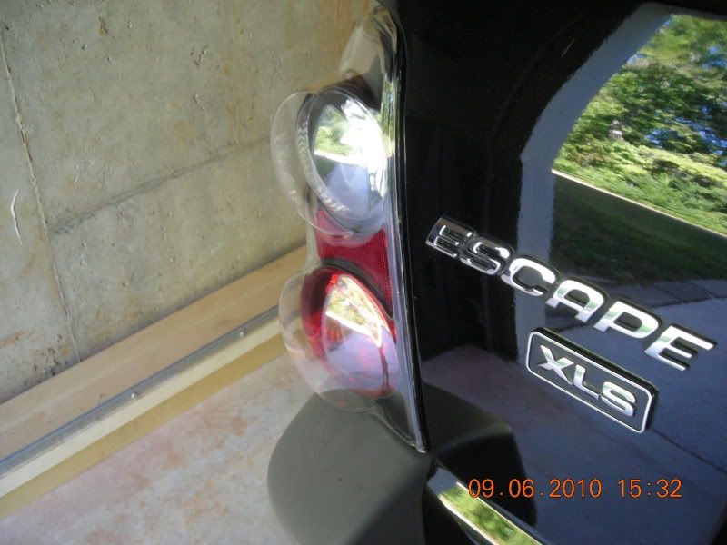

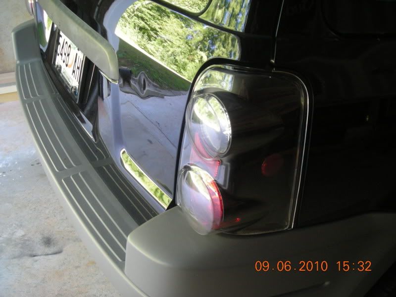

I just got my new Altezza style lights on and they look great! :wave: I think it gives Smokey a new look. The only problem is that when they decided to manufacture them en masse, they simply took the one mold of the driver side and flipped it for the passenger side. This creates a problem when you plug in the top bulb assembly. :bust: On the new light housing, the bulb assembly ends up going in straight up on the passenger side. This is a problem as you won't be able to use the supplied wiring harness. You must clip one of the little plastic tabs a tad to allow for free rotation of the bulb assembly. It's only five seconds of work, but it's enough to be a bit annoying if you know what I mean. Other than that, no fit problems at all!
