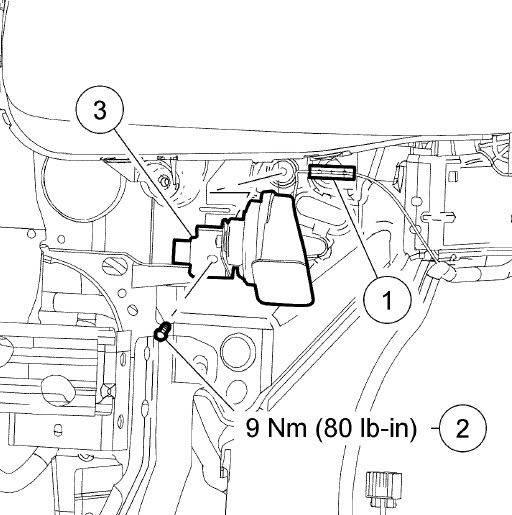

The Edge's dual-note horn should fit right into the single-note 2008 Escape horn's place. It even uses an identical electrical connector. You may need to drill a hole for the Edge's horn bracket, which has a small tab that's offset 90 degrees from the Escape's tab.
2007-2008 Edge horn (behind and below the headlamps on the passenger side):
2008 Escape/Mariner/Tribute horn (behind and below the headlamps on the driver side):
The Edge horn part number is 7T4Z-13832-A.
