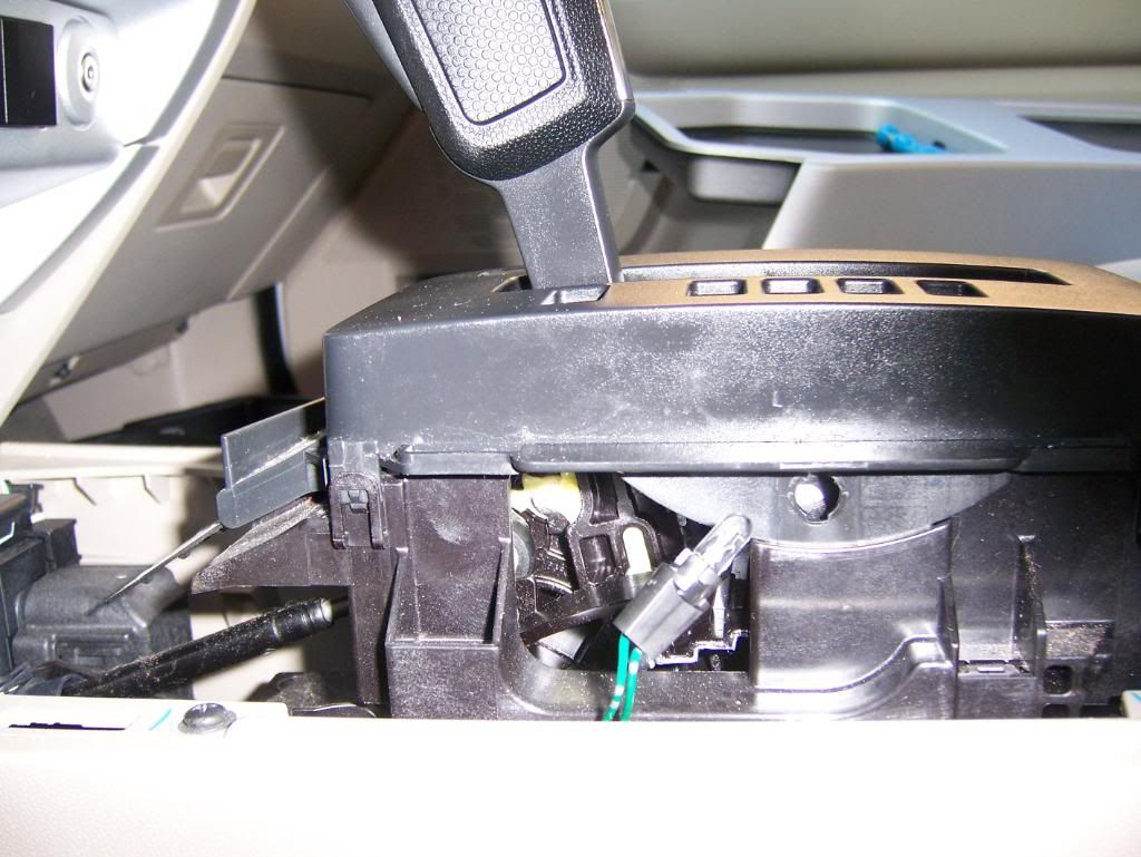

same issue here on my 08 mariner. did anyone ever resolve this issue? id rather not have to take apart all the console for a bulb but will if necessary.
hopin it was maybe just a fuse but i dont see a designated fuse. any help would be appreciated. thanks
****update****
figured it out and to some pics. pretty easy.

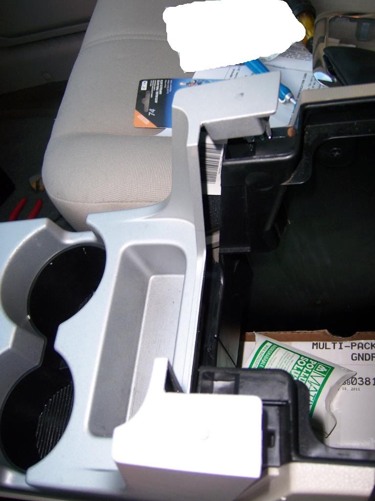

2008 mercury mariner hybrid transmission shift lever back light replacement

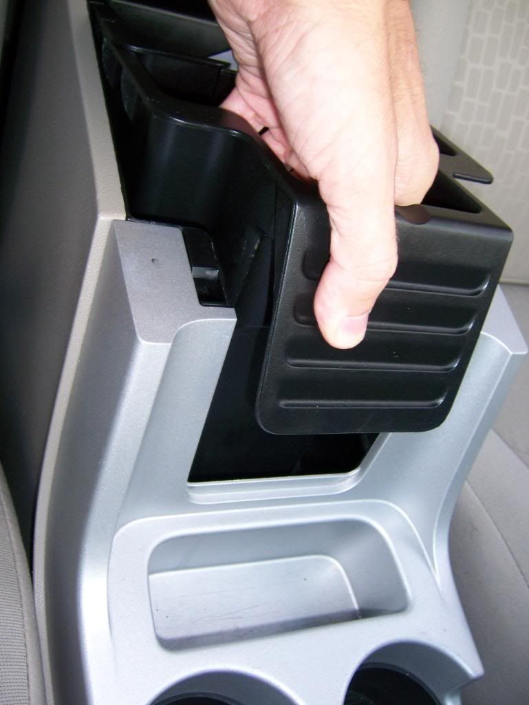

1.take out the storage bin

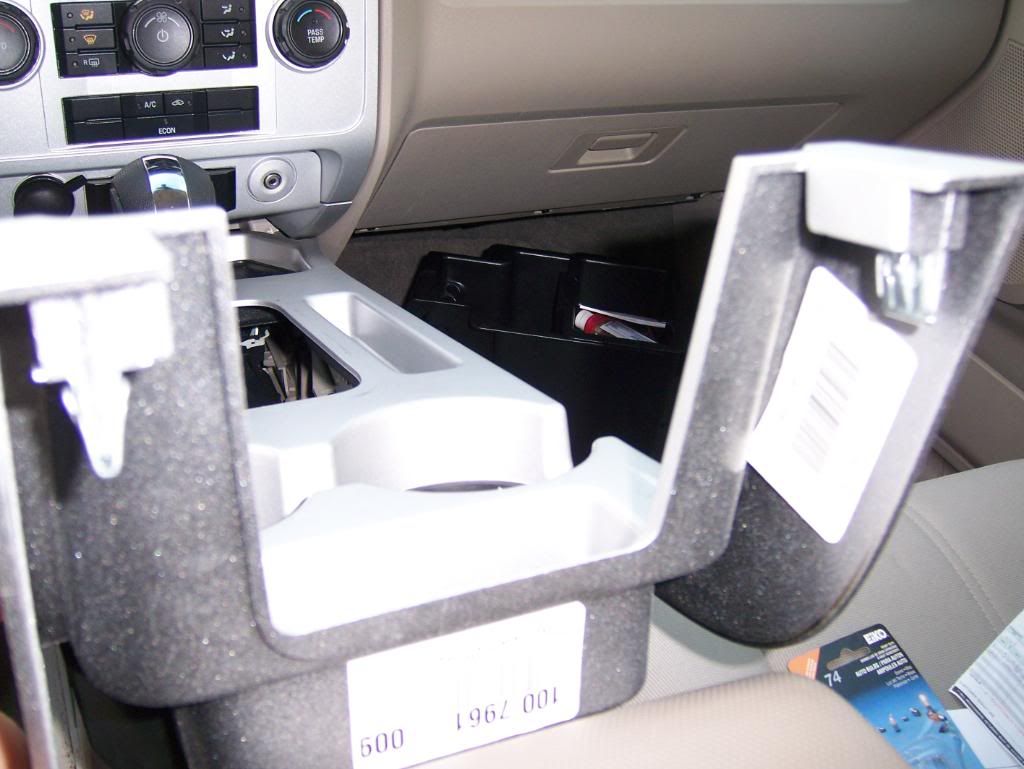

2.I forgot to take a picture here but use a thin tool (flat head screwdriver etc.) and slowy remove the silver rectangualr trim piece that goes around the transmission lever (P,N,D,L)
3.use a flat tip (if necessary) and pry up the two retainer clips and up

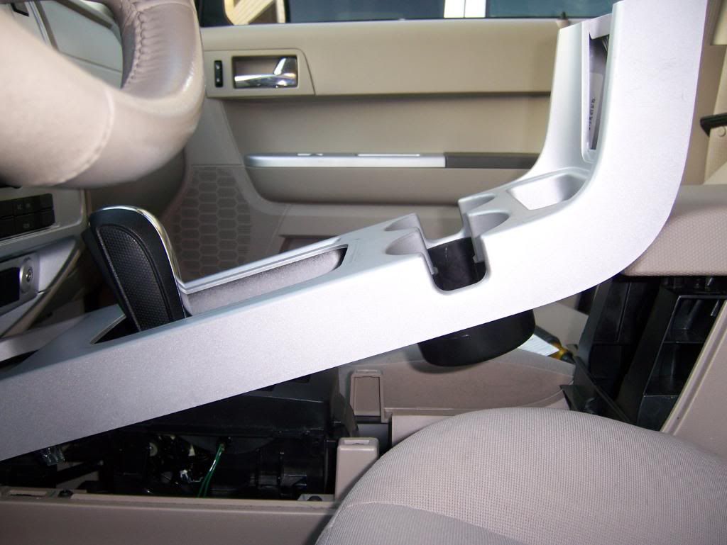

4.retainer clips
continued.....
10 Posts

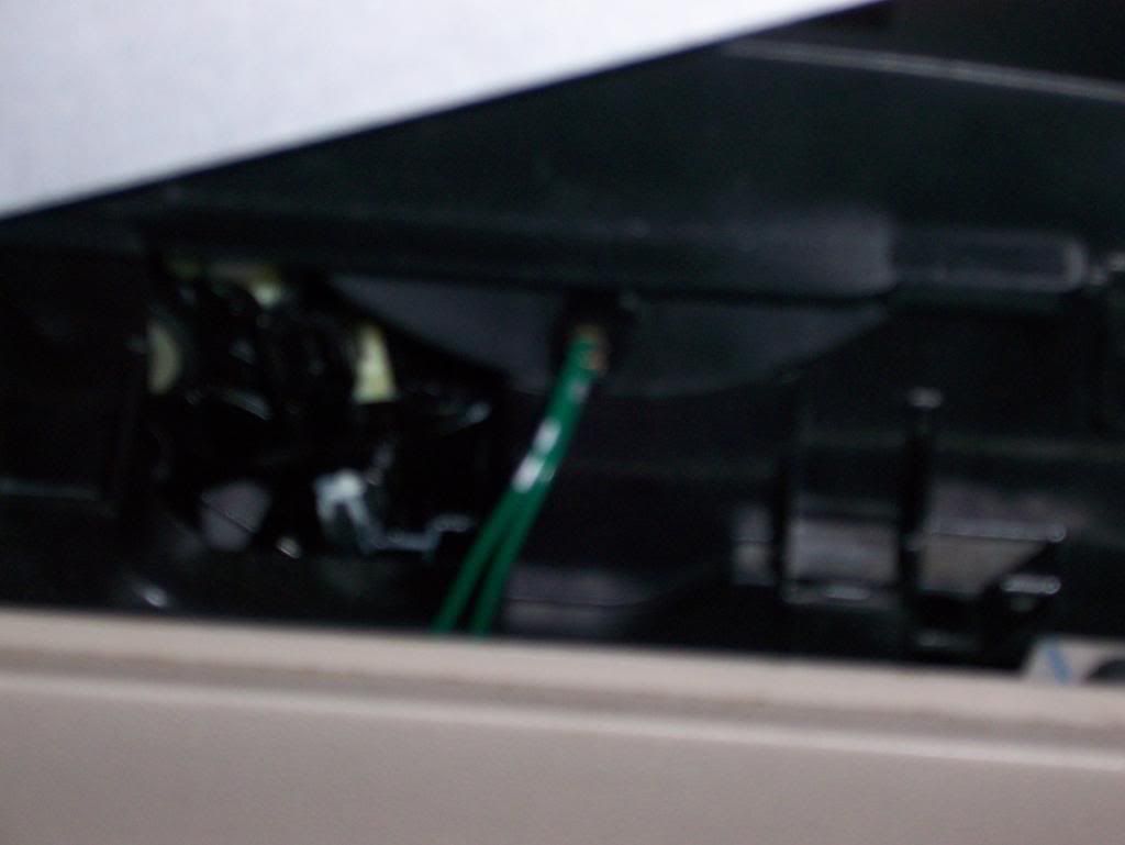

5.push forward and towards the front of the vehicle and remove the top assembly. (notice the green wire on the left, that is the backlight)
7.twist and remove the light socket from the plastic under the transmission lever.
8.replace the light.
9.extra lights
now just got backward from hear and youre all done!

Just used this guide to replace the gear shift bulb on a 2009 Escape XLT. Followed the guide exactly and it was very easy to replace. I used a #74 blue LED equivalent bulb, but any normal #74 bulb will work. Quick caution on LED bulbs, the fitment for the bulb is very tight, so some LED bulbs may be larger than the standard #74 bulb. My LED bulb fit, but just barely. Other than that, great guide and an easy but helpful fix.
9 Posts
Found the info very helpful for replacing the shifter light on our new to us Escape. However for me the #74 bulb was to big & wouldn't fit back into the hole. Went and got a #73 which matched the original and worked fine. Thanks again to texasboy :beer:
