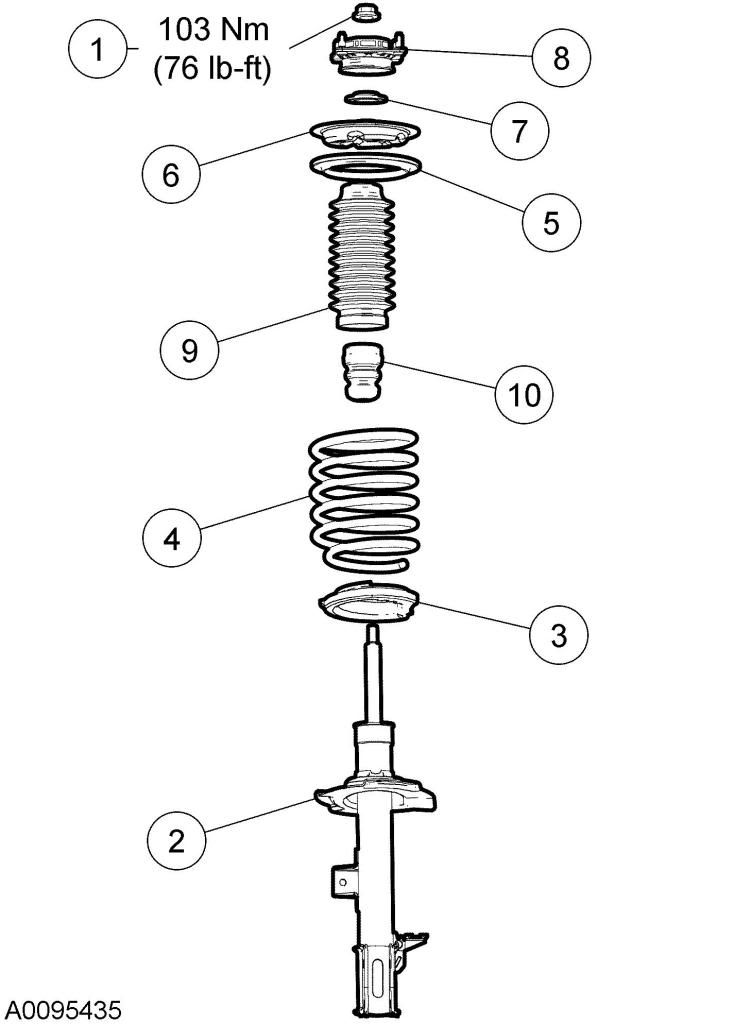

Can anyone please tell me what is this strut part from my 2005 Escape?
It came either in between Part 7 (Bearing) and 6 (Bearing Plate) or in between Part 6 and 9 (Dust Boot). I'm not sure of the order because when I removed the strut nut (Part #1) the spring shot out and so did the upper pieces.
I replaced the struts and shocks with Monro Sensa-trac and the ride was immediately stiffer. I also installed a new Bumper (part # 10) and a upper coil spring insulator (part # 5). I will change the break pads and rotors this weekend (ProStop Ceramic and Duralast). I am doing this to get rid of this new noise that recently started whenever I ride over a rough roads (56K miles).

I took off the struts again to have another look. It is possible that this broken plastic piece is from the bottom of the strut boot and not from the top. I took the broken pieces and place them over that location and they seem to fit. However now it seems that I need to buy these boots. I've reassemble everything and it seem like the noise has subsided a bit. Any ideas or first hand experience would be helpful.

Can anyone tell me if this thing belongs at the bottom of the strut boot?

That part you looking for is from bottom of strut mount it's come together as kit when you purchase new strut mount.The squeaking noise also can come from strut mount.You can visually check that if is rubber broken somewhere.On my Escape that squeaking noise driving me crazy for over two month until I find out that was from strut mount.

That piece of plastic goes in between parts number 8 and 7. It is hard to imagine that this little piece of plastic is directly in contact with and being compressed by the upper strut bracket and the bearing plate.
Here is the conclusion of all of my recent efforts. The strange noise that I encountered when I started all of this was coming from the BALL JOINTS. That was the last thing that I changed on my SUV. So here is the items that were changed in chronological order. Struts, shocks, strut bumper, spring insulator, break pads and rotors, upper strut bracket, and ball joints. All of these items are wear items so it doesn't hurt so bad when I tally up the prices for them. It sums up to around $650. :cry: Luckily I was able to do all the labor. Also I changed the thermostat, radiator hoses, and heating core hoses. I flushed the antifreeze and lubed all of the suspension parts when I was doing all of this. Next project is in the spring of 2010. By then I will change all of the belts, PVC, IDC, MAF sensor etc...
