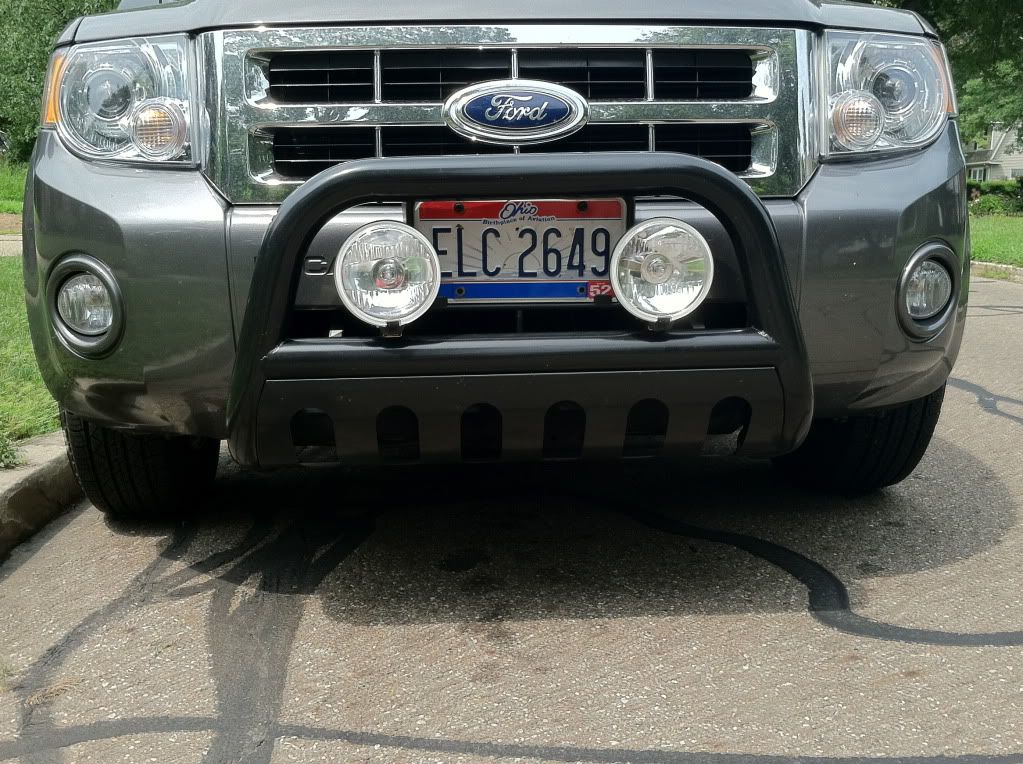

Craven Speed "Stubby" antenna
thats it with the orbital shrouds

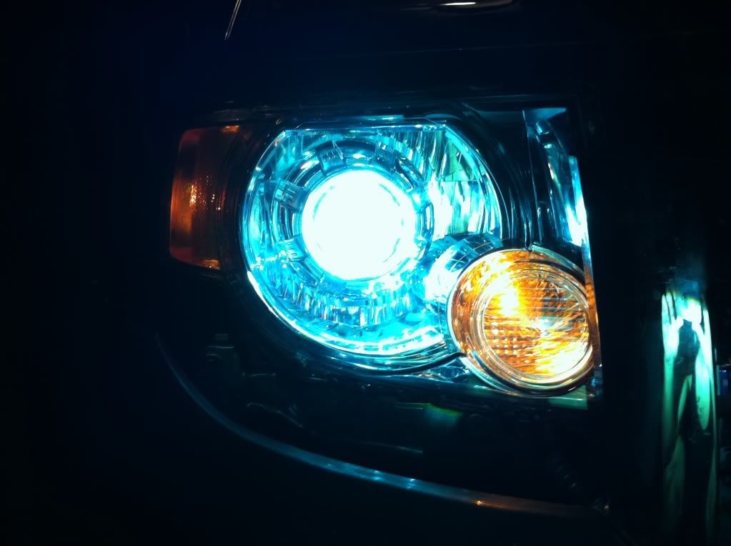

These next few pictures look discolored but i think its because of the angle and its my iPhone camera. In person they look diamond white and not one hint of blue.
Right headlight (left looks identical)

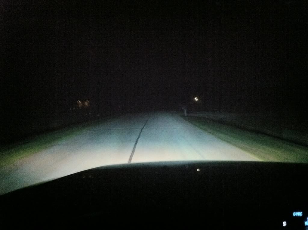

128 Posts
heres a picture i took on my street. The picture doesn't do justice. The light spreads about 15-20 yards off each side of the car and about 50 yards ahead. Cut off lines are great.

With halogen bulbs, the light typically extends farther down on the right side to better illuminate the shoulder. I can't tell from the pic, but is that the case with the projectors, or is it an even lighting on both the right and left?
I think they look great, and most importantly, they're HIDs done right (i.e., full projector setup) :thumb:
