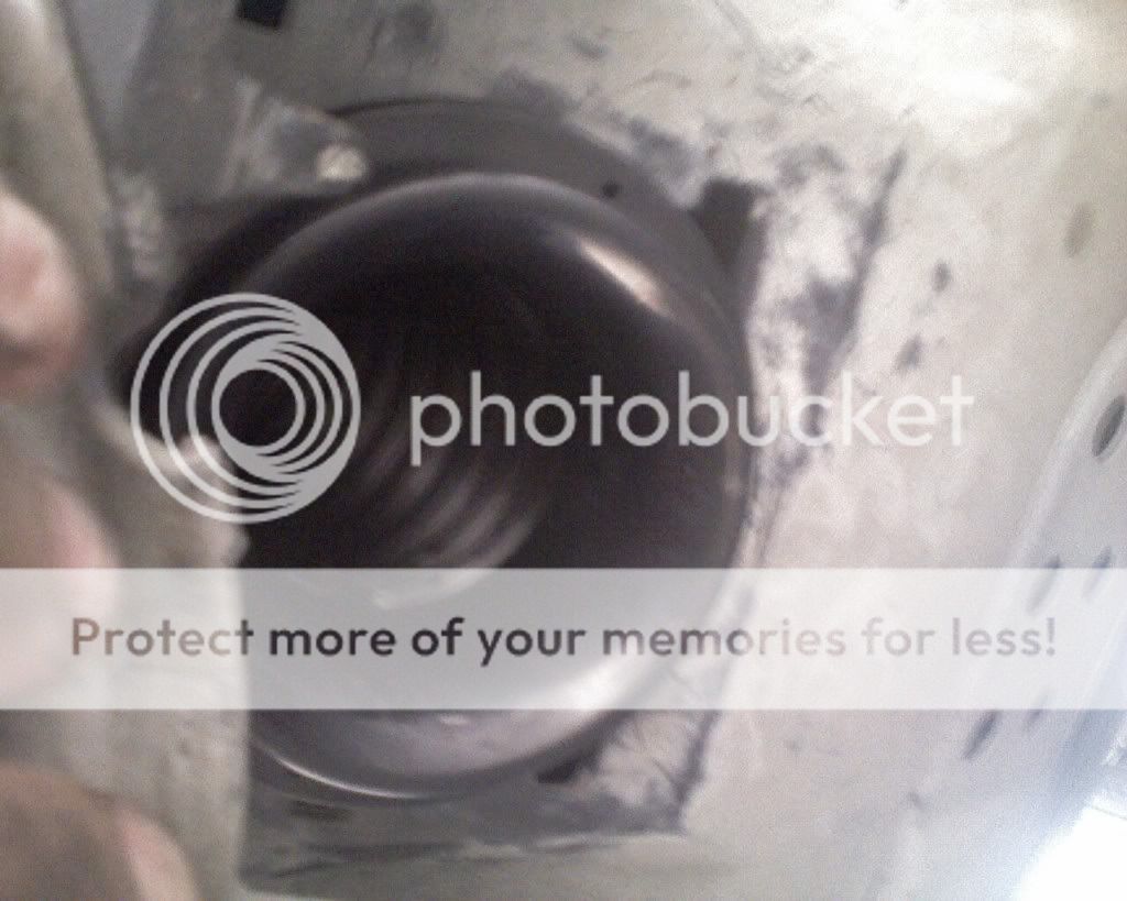

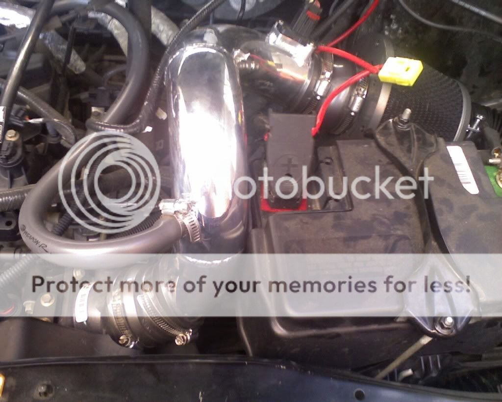

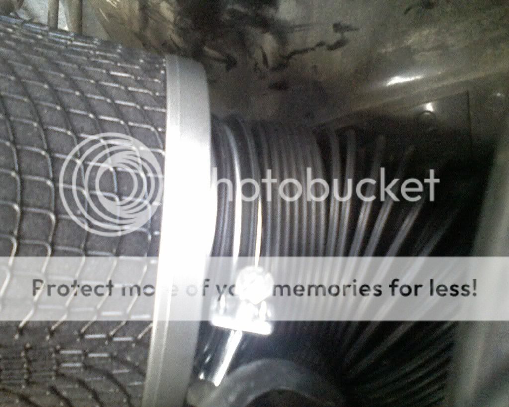

his is the set up of the Weapon R secret weapon intake. It comes with the whole intake including the ram air part. Very easy set up it took me about one hour. The ram air goes where the original ram air tube goes but I continued to extend the tube to just behing the bumper under the engine.
The escape feels with the engine more relaxed and it has improve acceleration. I have not have the time to verified the MPG. What I am goint to do is a heat shield with some sheet metal that I can get at work. I bought this in racinglab.com for $198 plus free ground shipping

Where does the intake end up? It doesn't look like a ram air intake to me.
And like Jonas said, the computer will always adjust for optimum fuel mixture so you likely don't get any gains in power, but a less restrictive intake can give you better throttle response which feels like power.
That's true, you will get some better tip in response when your accelerating or when you need to pass a slower vehicle. It'll feel much more responsive, and less numb than stock. And that's a good thing! :yes:
