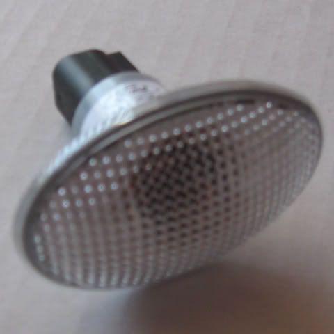

2008 and newer E/M/Ts can't use the older mirrors, unfortunately. For those models, I'd use Ford's factory repeater lamps from the Mariner, which match the shape of the door handles. The repeater lamp (clear lamp housing, amber bulb, and socket) part number is 5E6Z-13368-AA, and they're inexpensive (around $3.60). They require a connector and pigtail wiring, which is part number WPT-150 (about $17).
Of course, you'll need to cut into the fenders to do this.

The repeater lamps from the 2002-current Mountaineer fit perfectly on the flat area under the mirror housings. They're not flat, but close enough.
1L2Z-13368-BA is the part number (about $12 each), and the WPT-489 wire/pigtail assembly (about $20) plugs right into it. Replace the amber bulb with a #168 or #W5W, and wire it to the interior lamp circuit.
These lamps also make perfect interior lamps in doors.
