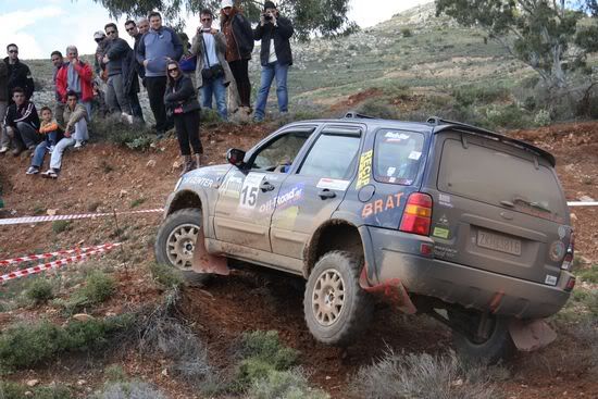

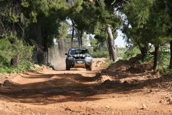

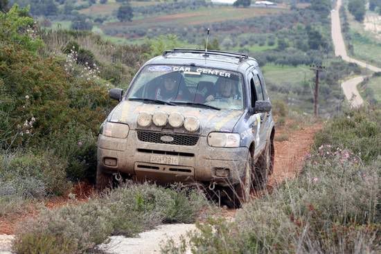

Not the slightest engine modification...but with a little bit of lift and careful choice of suspension parts,together with some outside and inside protection and with the help of some extra navigation instruments, the Escape works wonders.Faithful as a dog and that is why I called her Argos.
Long live Argos!
Argos is tough lookin'!! Great pics!! :thumb: :thumb:
Awesome! Keep up the fun, and keep the pics coming.
Looks like some sort of organized event? You look like a pro.

Impressive images. You'll have to give more details on the suspension upgrades.. as long as they're not trade secrets :calvin:

Very impressive! :thumb: I was with a group of Escapes that went thru stuff not nearly as drastic as that and couldn't make it home. Nice to hear the mods you made worked! I hope you and Argos have many years of fun together :peace:
