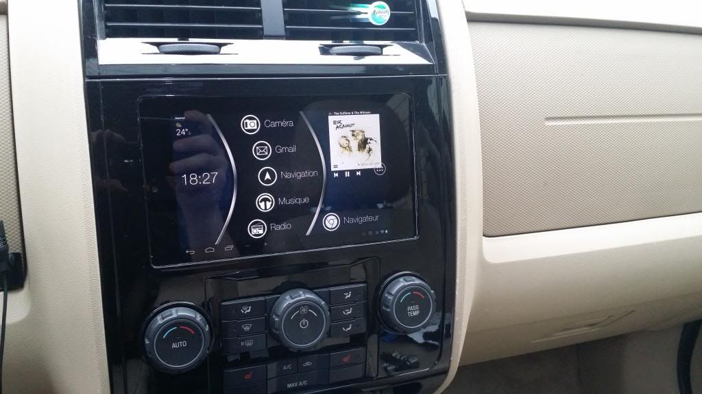

Postby Escape94 - May 25th, 2014, 8:04 pm
Very nice, :thumb: how did you do the tablet install?

Postby Meatloafmountain - May 26th, 2014, 2:04 pm
Escape94 wrote:Very nice, :thumb: how did you do the tablet install?
I was wondering the same thing.
Looks very clean.

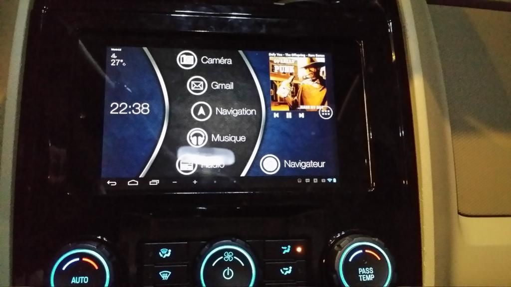

Postby joe540 - May 26th, 2014, 2:57 pm
I bought a Metra Double DIN kit and made plastic strips that pass behind the tablet. I moddled it into the Metra kit. It's pretty solid enought, but I need to adjust the tablet a little (The right side is a little bit lower than the left one).
**I'll try to take pics from behind when i'll adjust it so you can understand easier
Behind that, there's a 12V-5V transformer, ignition-switched by a relay, powering a USB HUB and the tablet.
There's a Joycon EXR for steering wheel control (I still work on that, because the nexus 7 don't want to recognize it), a Pyle PLMRMP3A 4-Channel marine amp (Small enought to be in the dash, so I didn't have to pass speaker cable anywhere), there's a Behringer UCA222 DAC also.

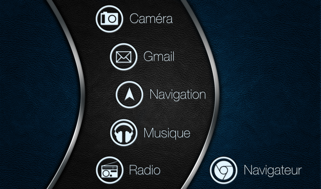

UI is an idea of a mp3car user (rxritalin), who gives his photoshop file to anyone wanting to use it ( see the post ).
If you have any questions about it, don't hesitate!
