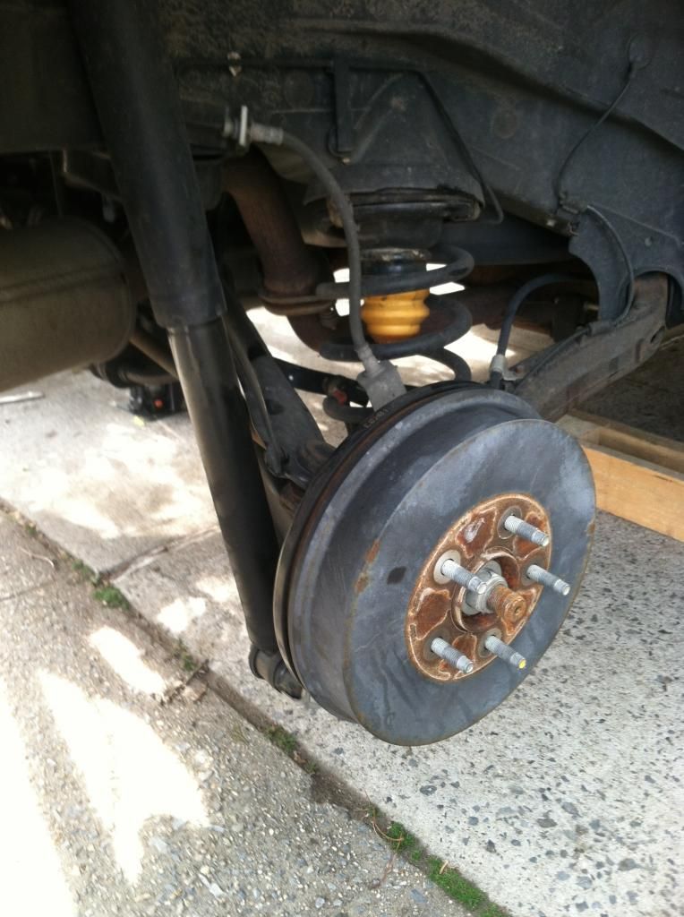

First you need to lift your car on a jack(if you have jack stands use them if you don't, it is a good idea to get some).
Next remove the rear wheel to have some room to work.

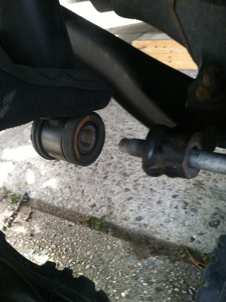

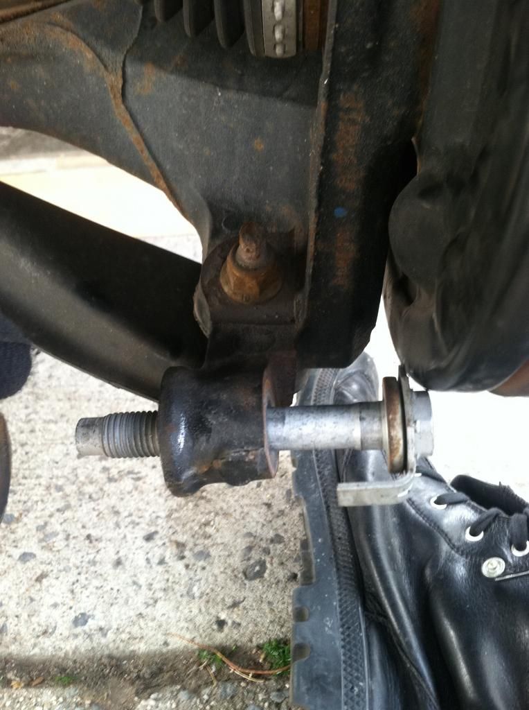

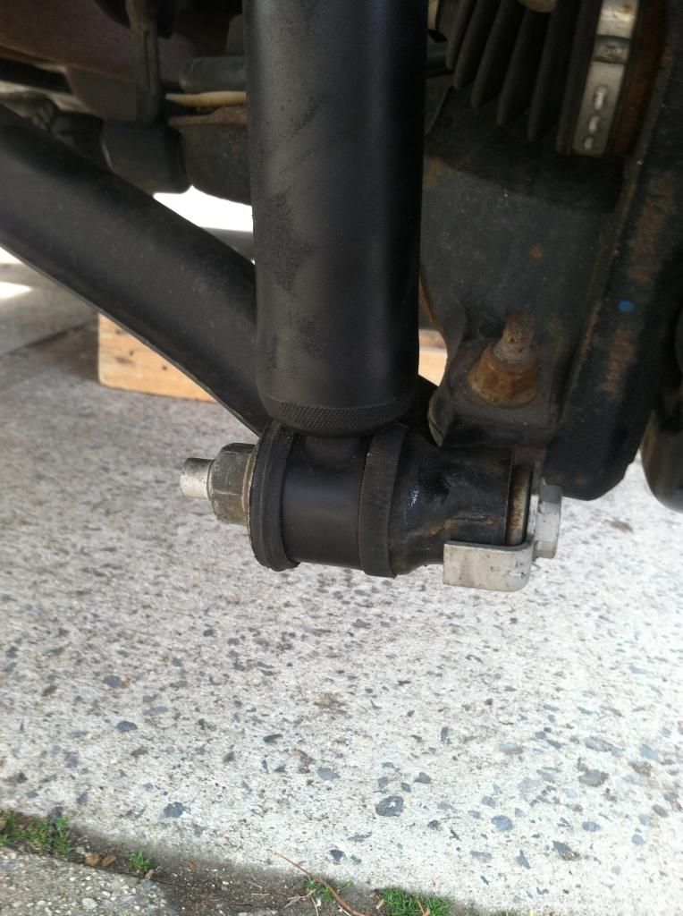

Next find the lower shock mount
Next remove the nut holding the lower shock.
You may have to use a rubber mallet to hit the bolt out from the mounting point.
The bolt came out fairly easy when I pushed up slightly from under the brake.

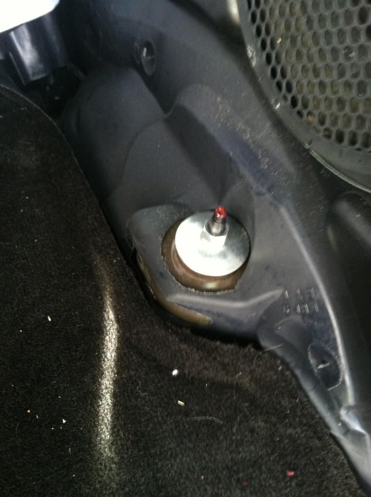

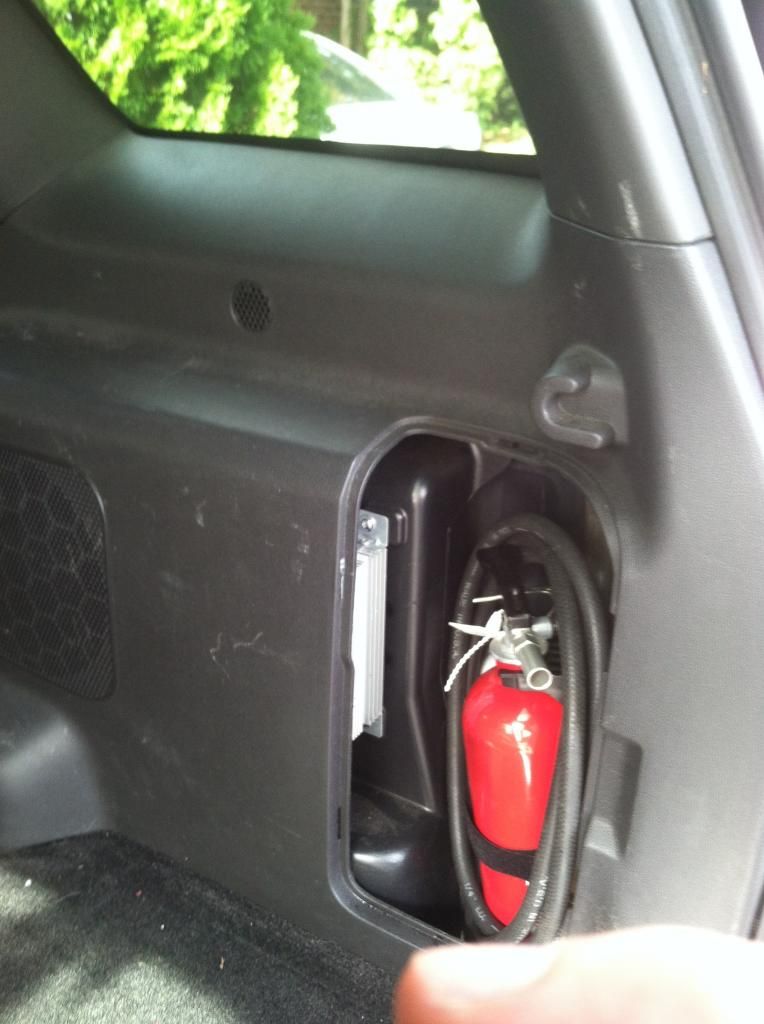

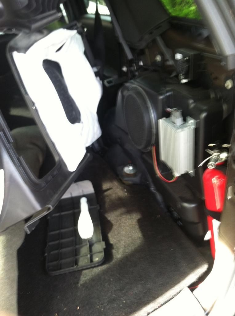

Now go into your trunk and take off the side plastic panel. It is all attached by clips to I carefully felt around the panel and pulled it off. I found it easier for the passenger side if you remove the "secret compartment door" on the side and pull the tabs loose closest to the rear.

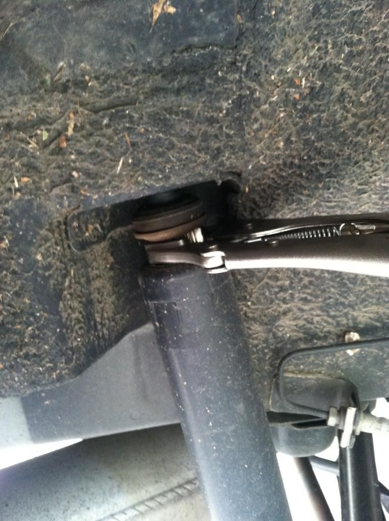

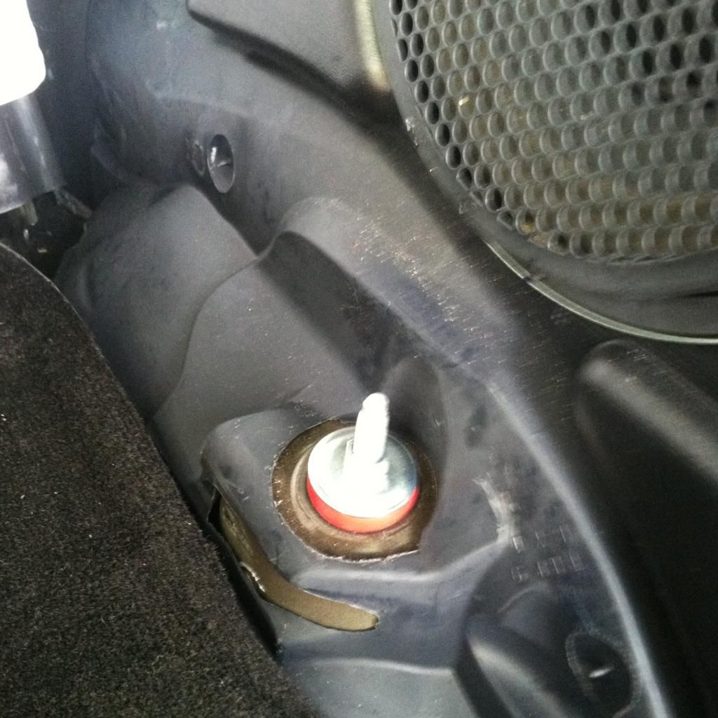

Now look for the top mounting point of your shock.

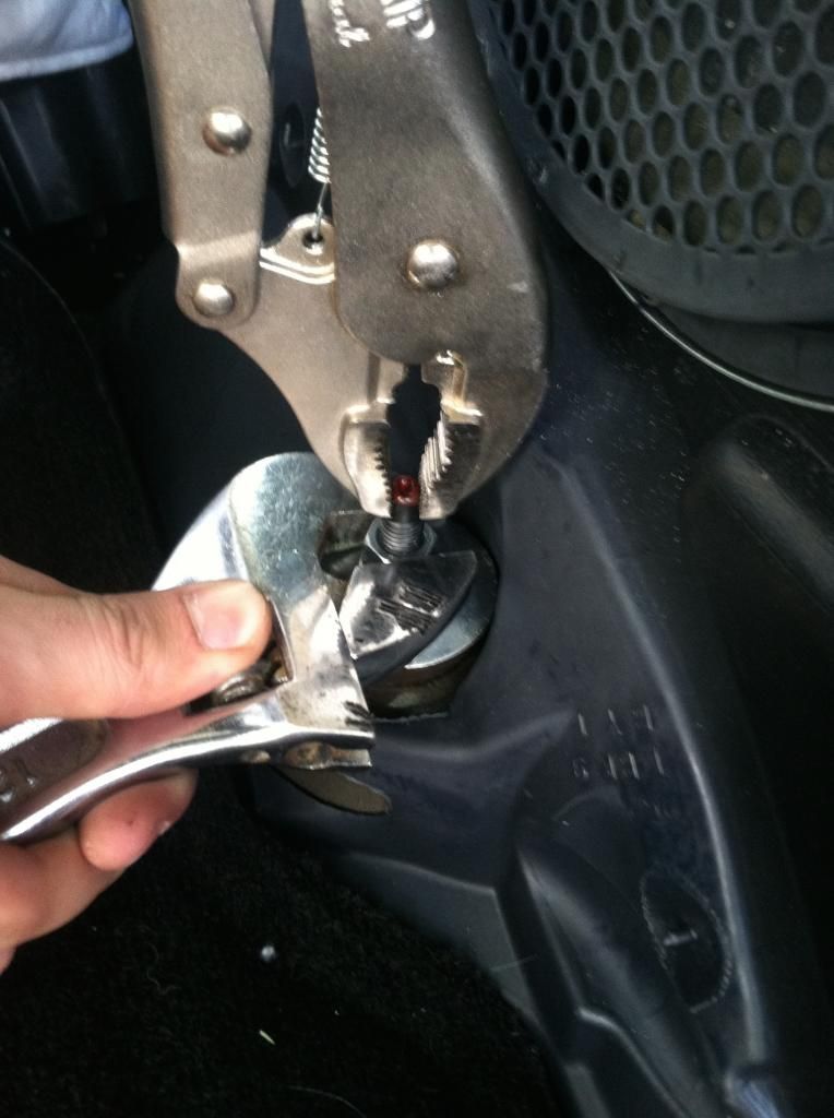

I used an adjustable wrench and a visegrip to get the nut loose.
Then the nut was being stubborn so I had to go from underneath and hold the top of the shock and I loosened the nut off completely.
Now remove the shock and set it aside and go back down to the lower mounting point.

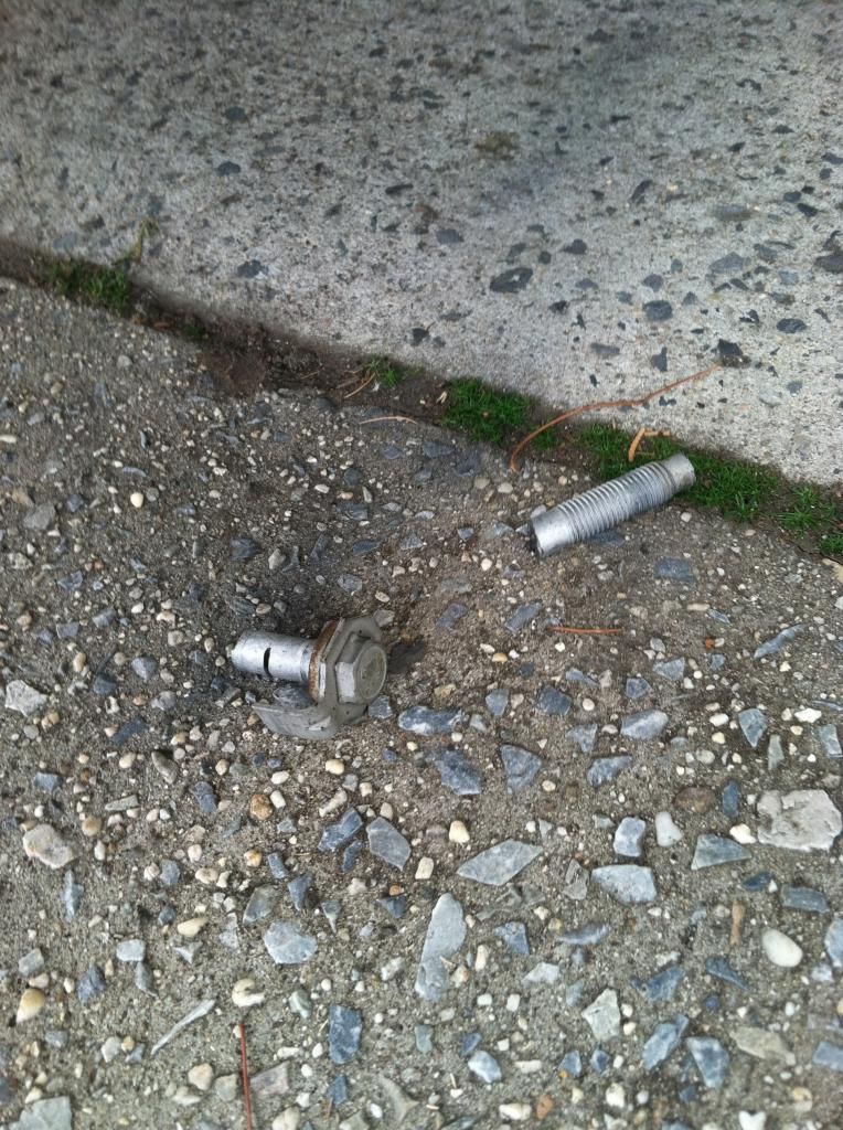

You will see that Ford decided it was a good idea to turn this into a puzzle. But here in 'Murica we just plow through problems like this so use your grinder and safety glasses (not fun getting molten steel in your eye) to cut through the bolt fairly close to the mounting point but not too close.

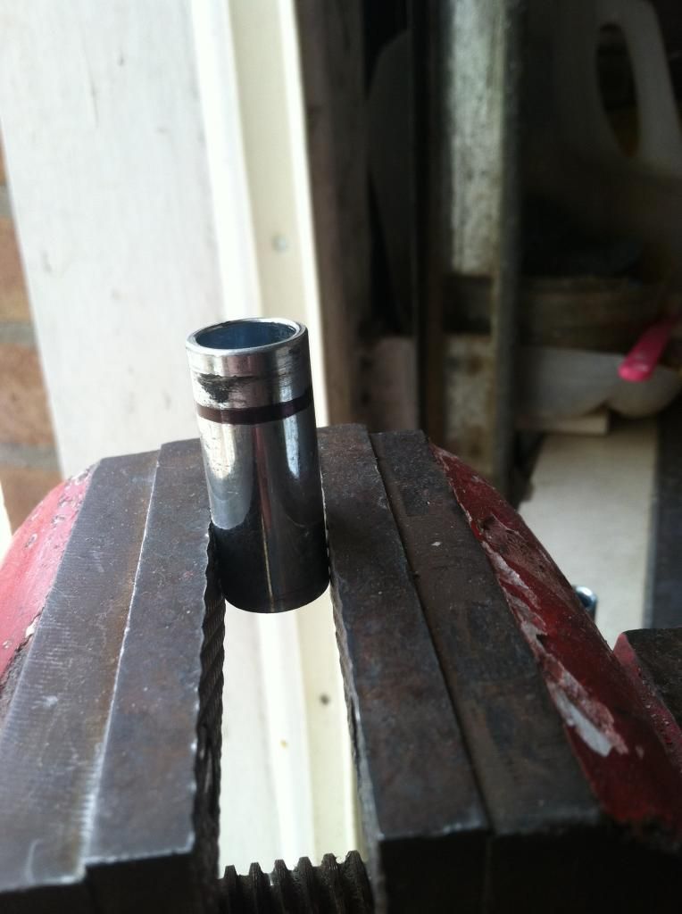

Okay so now grab your spacer and put it in the lower mounting bracket (mine was too long and I had to cut it)
So cut both spacers at once if you need to, it is the same size on both sides.

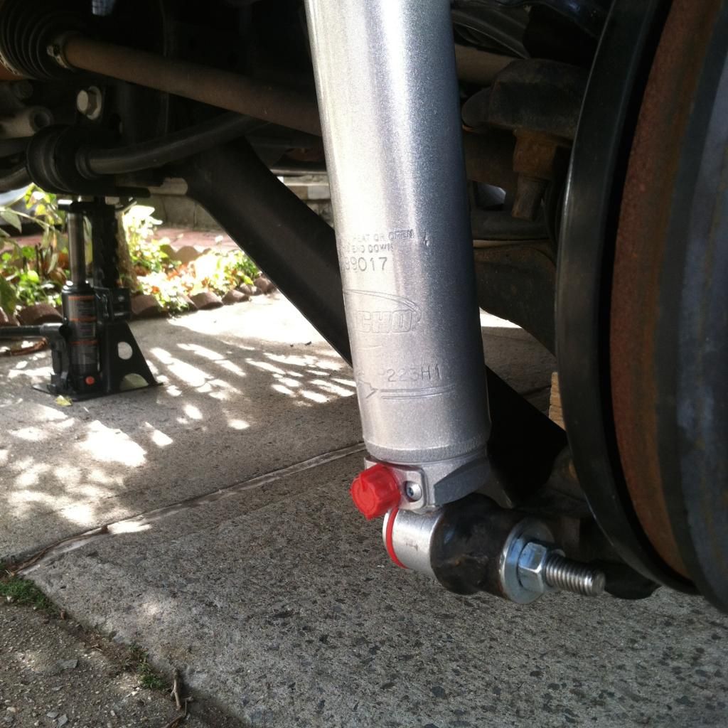

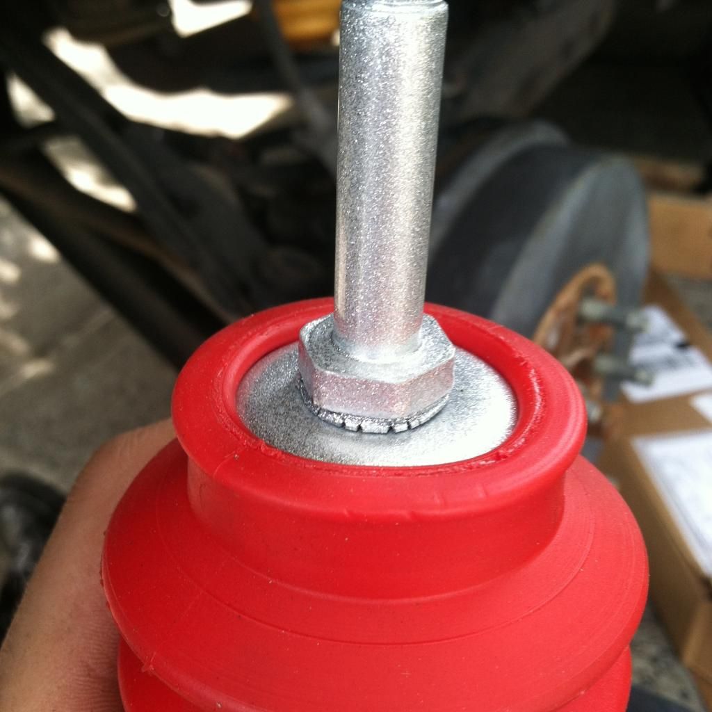

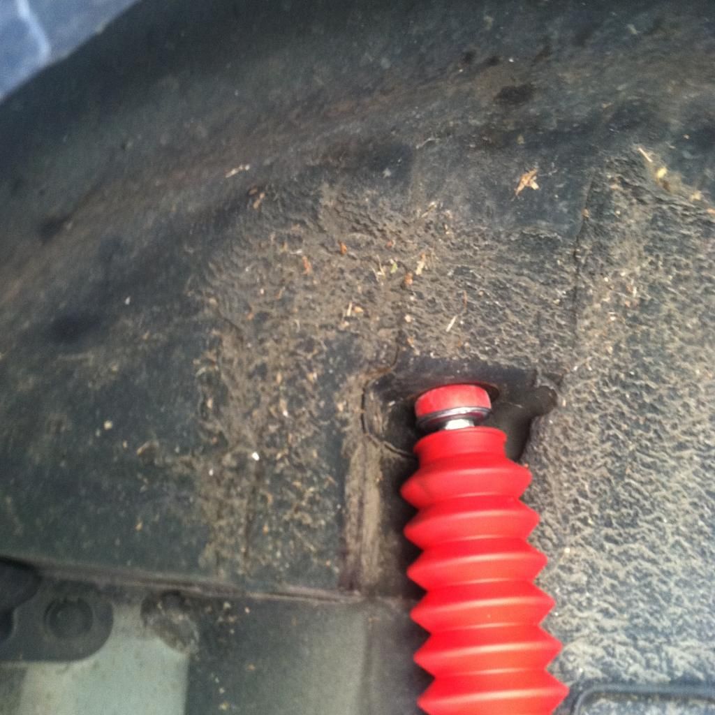

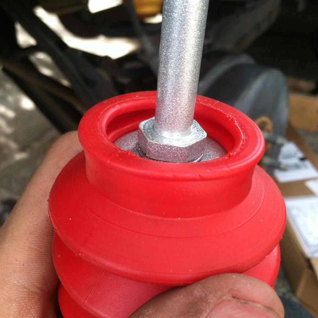

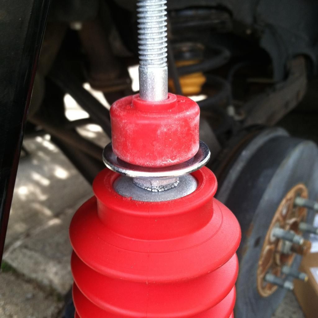

Now grab your new shocks and take out all of the hardware from the box. It should include a nut, a set of bushings and washers for the top mounting bolt. Also remove the dust guard from the box and install it on the shocks. Just the top part is fine for now.
Now, have a friend or (if you prefer to work alone like me aka my excuse for not having friends) set up a way to prop the shock into place (get creative).
If you mount the lower mount first the shock will not fit to reach the top unless you compress the spring on your car, it's just easier to mount the top first.

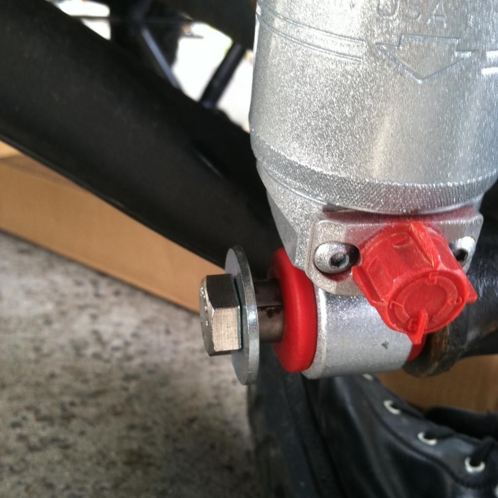

Now for mounting the bottom.
The shocks come with a metal insert that goes into the rubber bushing of the shock. Put this in now. Also set up the bolt with one washer on it.
Place your spacer into the lower mounting point of the shocks. Like the photo above if it is not in there already.
Next put the bolt through the shock and lift the bottom of the drum brake or the lower mounting point so that the bolt can go through the mounting point.
Next put a washer on the other side and screw in the nut.
Note* The bolt is facing the opposite way that it was initially facing.
Next make sure everything is tight and secure, secure the bottom of the dust guard with the provided zip tie, put the plastic trunk panel back into place. Slide the bottom into place first under the plastic piece at the rear of the trunk.

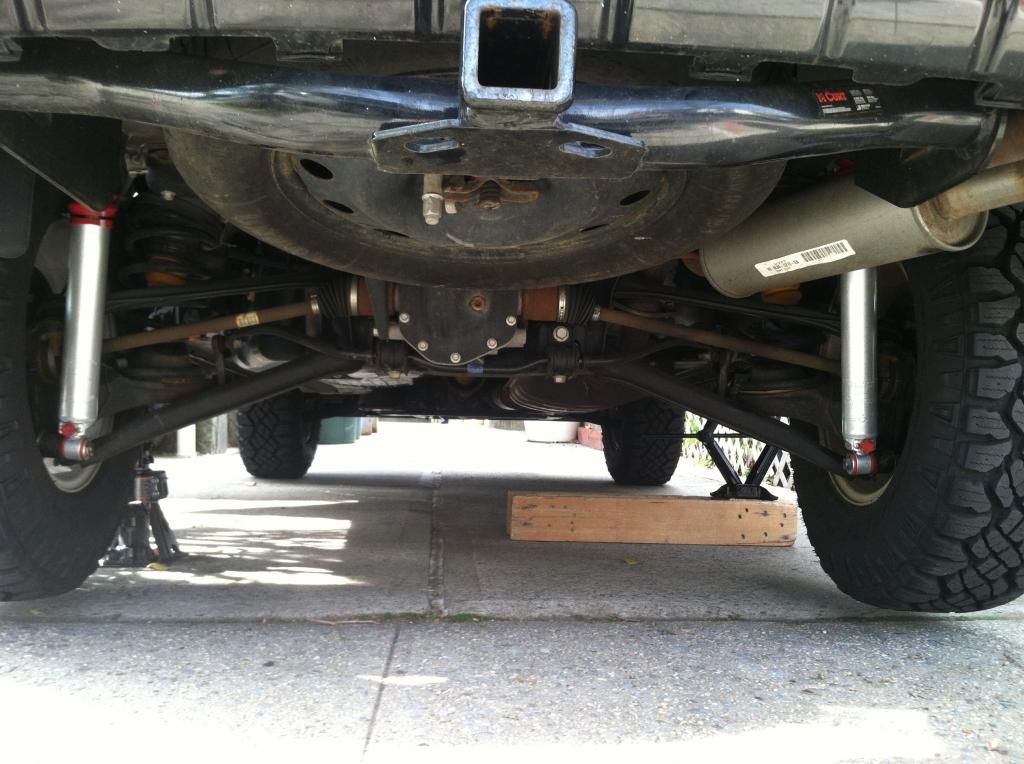

Lather, rinse, and repeat for the other side and you will have a nice new set of awesome shock on your E.
Goodluck!!
