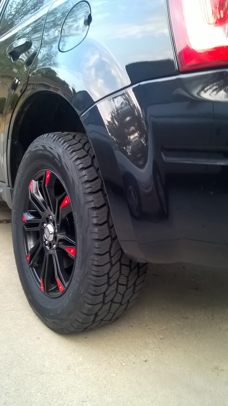

I have 235/65R17 Cooper AT3s, but larger wheels/ lower profile tires are out there that don't
adversely affect the speedometer.

I have a 2008 limited and got the 1.5 inch leveling kit. I put 265/55/17 firestone destination a/t's on and they looked AWESOME, but they scrubbed like crazy forever. This was was about 4 years ago and they are pretty worn so they don't scrub anymore. If you don't want to cut into the wheel well I would stay around 245 or 255.
