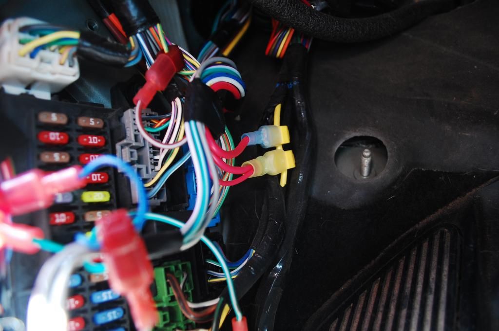

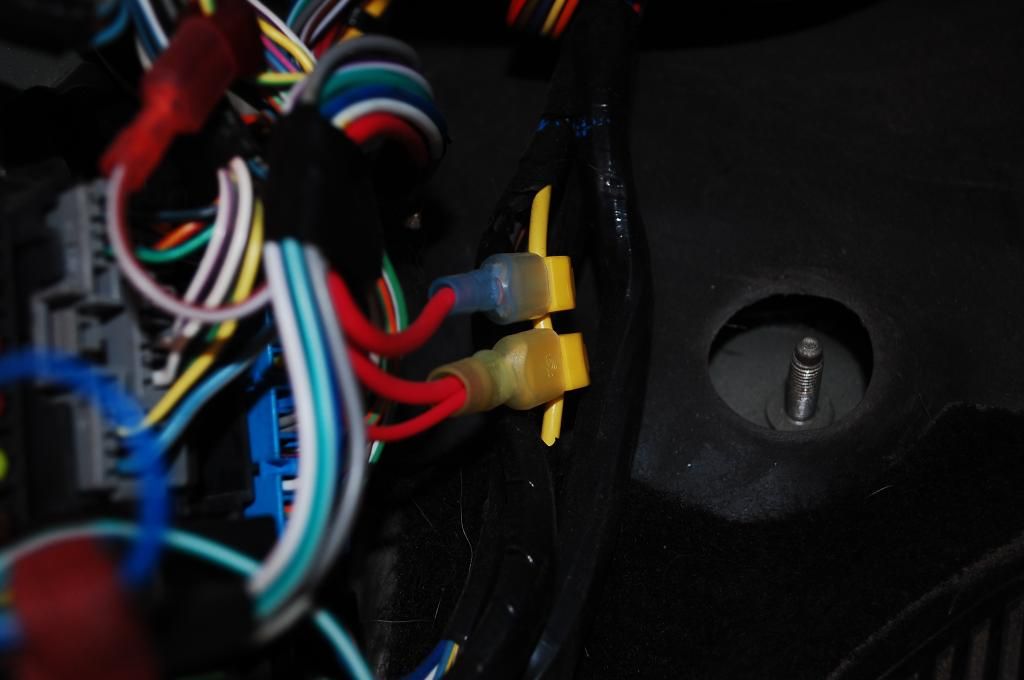

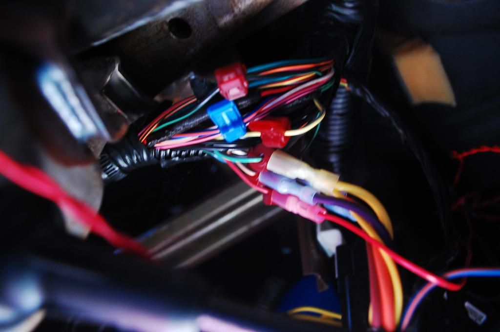

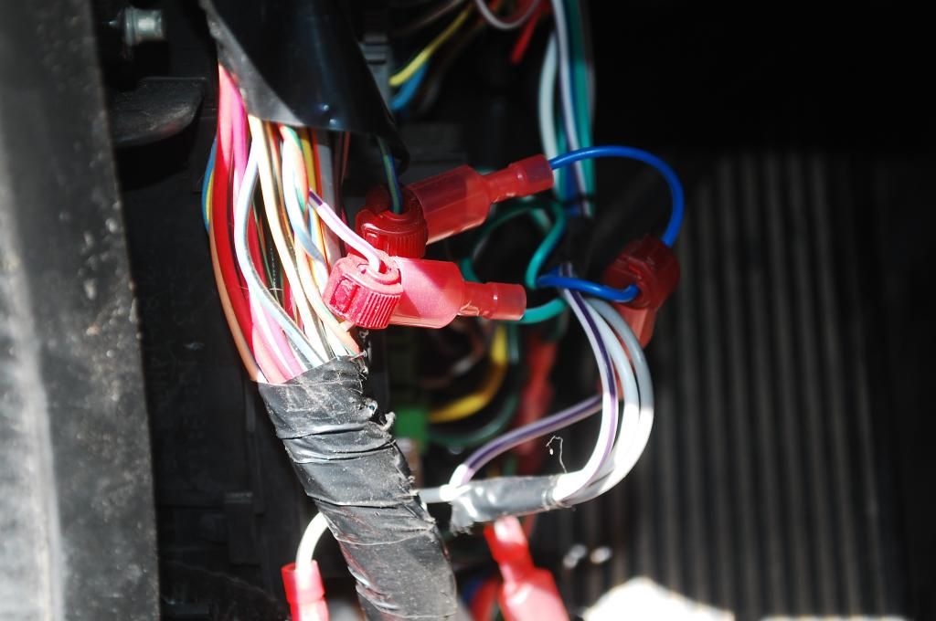

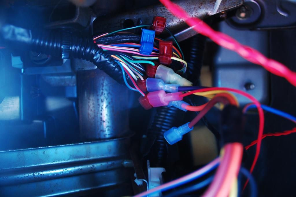

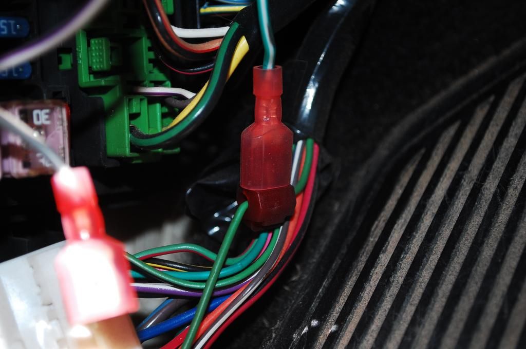

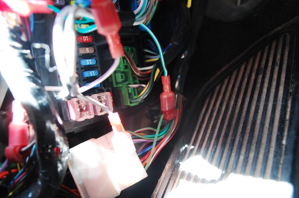

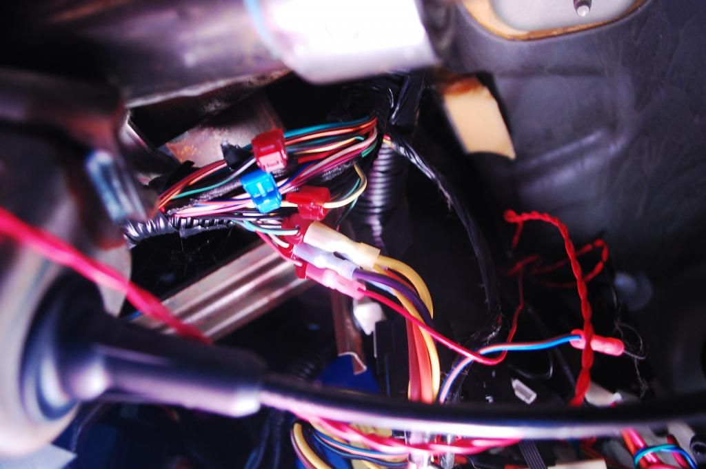

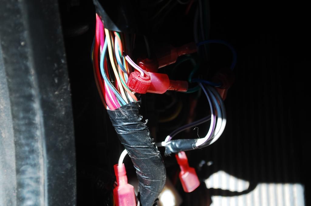

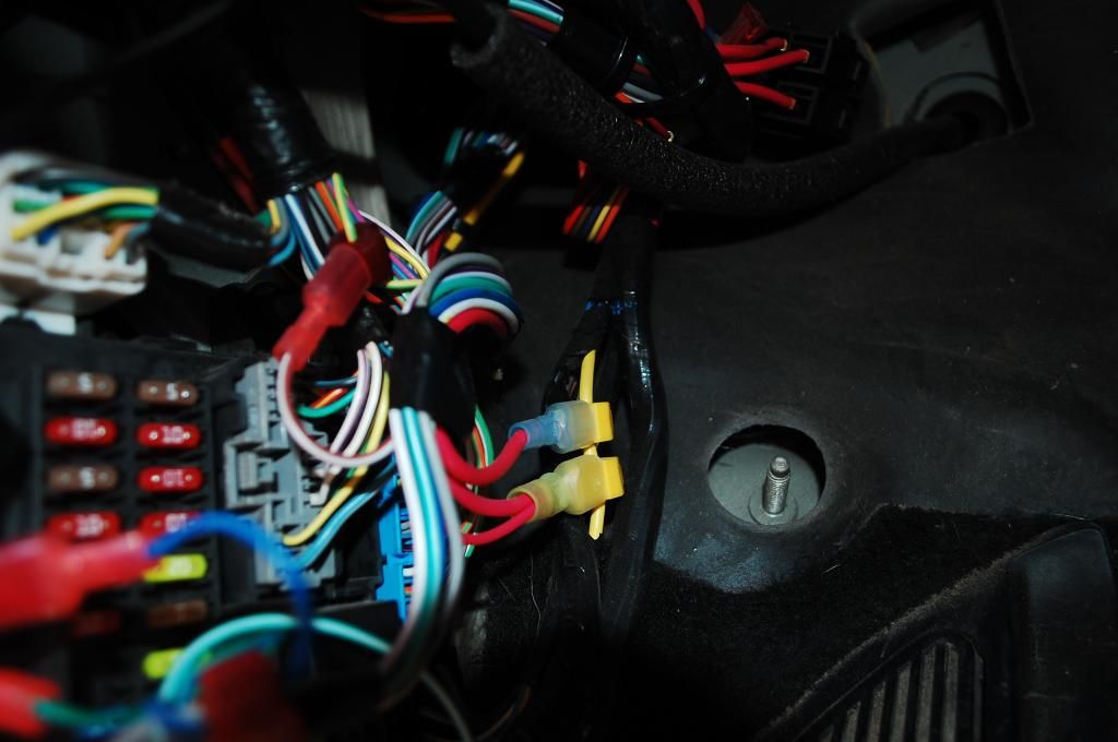

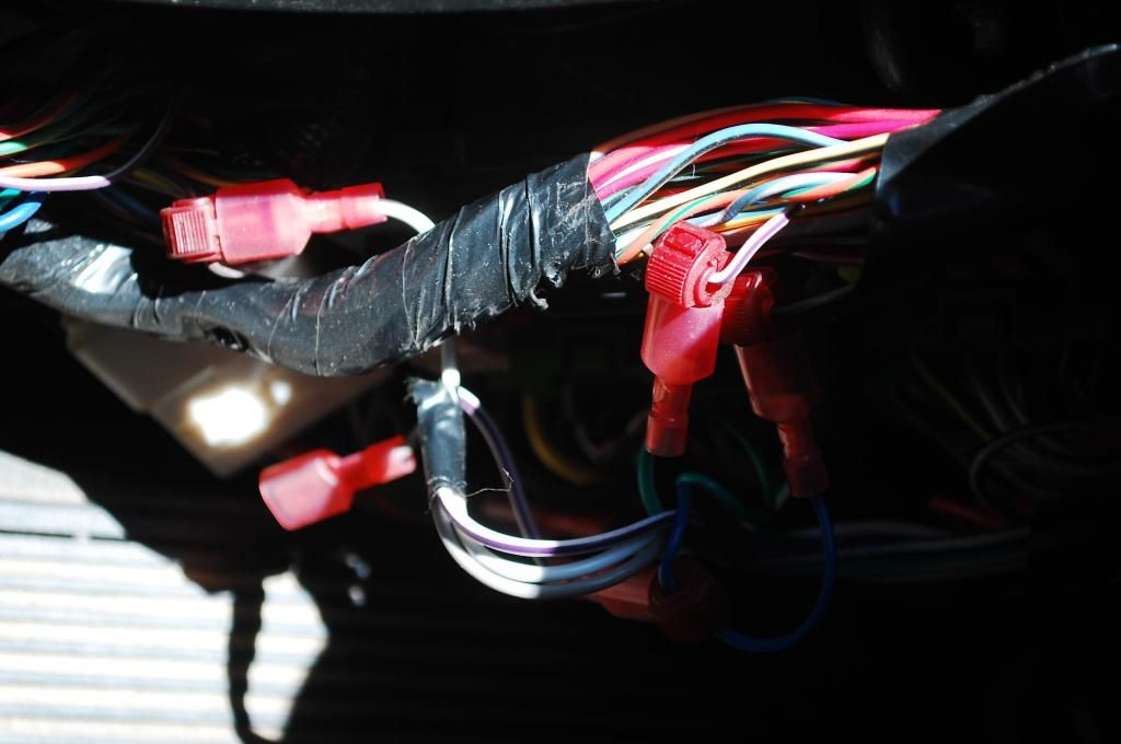

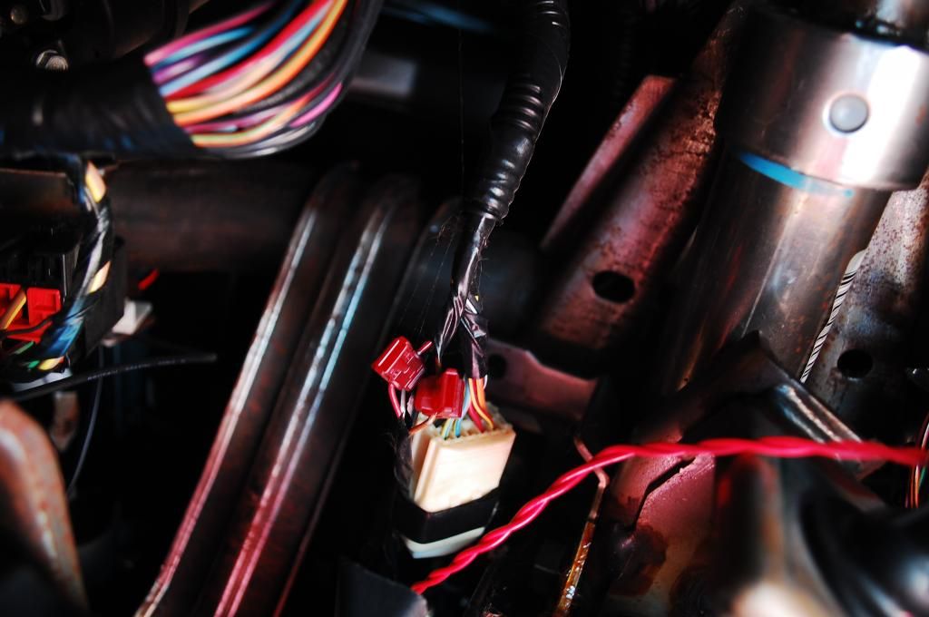

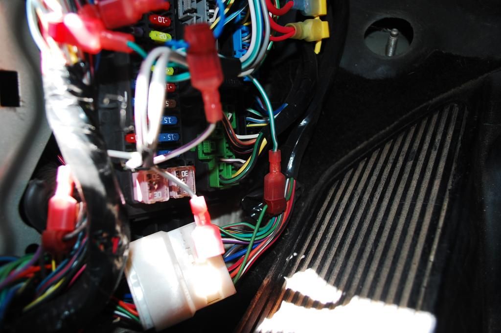

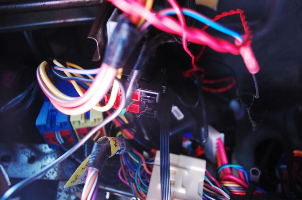

Took the battery out and had it tested. Checked out just fine. This was after it had sat all night. I took off the driver side kick panel looking for Terminal C263 but I can't find it. I did find a bunch of wires that have vampire clamps on them. Which is strange and not professional. I took some pictures. Let me know if this looks OEM.
Also, if someone could PLEASE help me find Terminal C263 inside and Terminal C134 in the engine compartment.
Please see this link to understand what I am talking about: http://www.underhoodservice.com/ford-te ... h-mil-on/#

#14 ·
mozz said:
What is all that mess? You must have an aftermarket alarm, remote start or aftermarket audio in that vehicle.
Nope. Perhaps the PO did? Not sure. But your comment definitely confirms what I was suspecting - the wiring is a mess. I suspect the problems I am having may have something to do with this? It is extremely hard to tell. It's not running well...
#15 ·

#17 ·
S-caped 1 said:
There is no way that rat's nest is is OEM. I'm not surprised there are electrical ghosts. That looks like a Frankenstein monster!
Damn... ok. I feel like if I try screwing with anything under there I'm gonna make it worse. I don't even know WHERE to begin to sort everything out. My guess is, if I took it to a shop, it would be hours and hours of labor and $$$$$ to get it figured out.
Straight up. Should I trade it in? I wouldn't dare sell it to a private party. I'm not that kind of person.

You're not gonna like this post. Just guessing. After re-reading the entire post, you said the seat bolts were rusty. I'm gonna guess this vehicle was a flood car. To me that means electrical gremlins. Follow some of those wires and see where they go, maybe a black box for remote start. If they just go back into the harness, appears somebody was trying to fix this before for a electrical problem.
#20 ·
You know, I figured if it was a flood car it would have been reported on the Carfax. That's why I just suspected being a New York car it was rusty from that. I wonder if it DID go through a flood and was never reported. Who knows. This car is taking up too much time as is. I have a 12 month old and digging through wires for hours isn't an option anymore. I really like the escape. A lot of bang for your buck. And I know it's not the car, just the prior circumstances that have led to what is going on with it now. Still, hard pill to swallow.

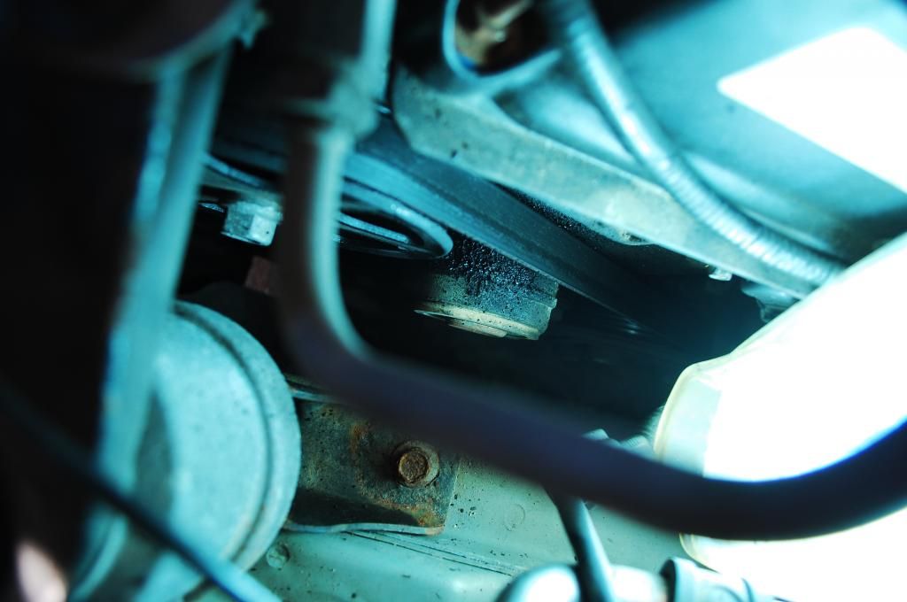

#26 ·

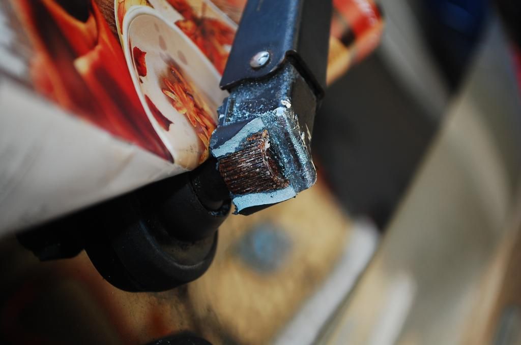

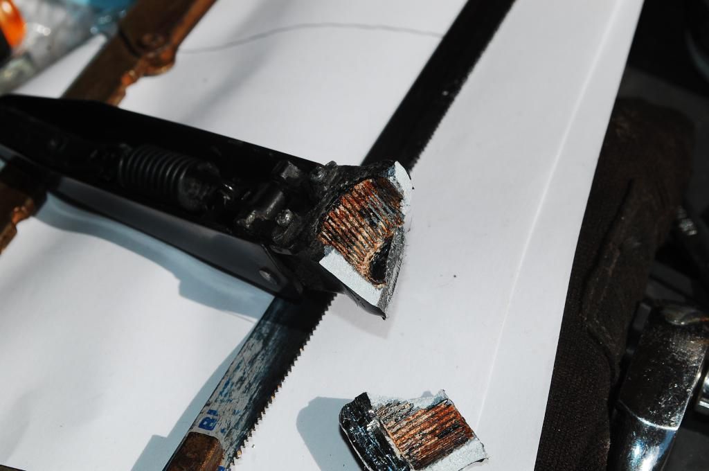

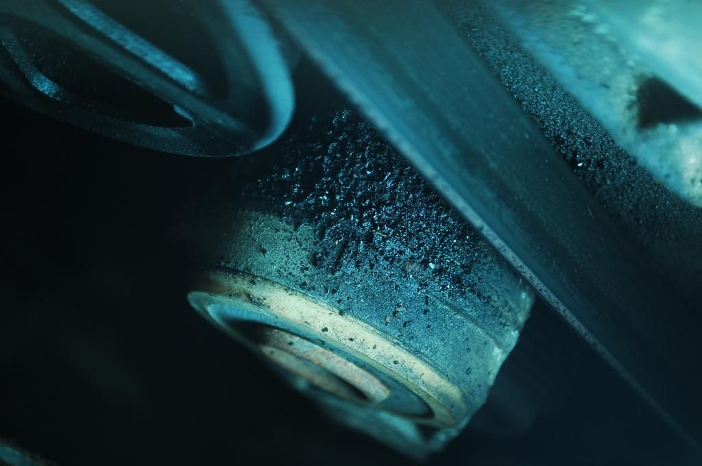

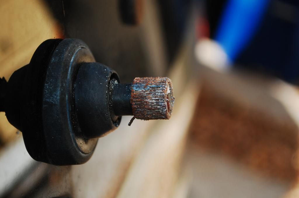

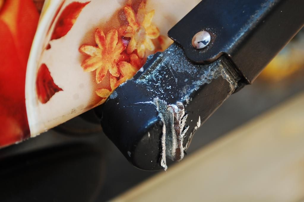

Not sure if anyone has ever had to replace the rear wiper motor, but getting the wiper off is a royal pain in the butt. I eventually had to just cut mine off. Surprisingly enough, the coilpack was easy to get out. Took me about an hour, but I could probably do it in half the time now, especially since I know what I'm doing.
To go back a bit though, I took it in to the Ford dealership to get the recall stuff taken care of (sticking throttle causing you to die & A-arm falling off causing you to die). While it was there, I had them do a deep scan of the computer for $110. They pulled up a coil pack #3 malfunction. When I asked why it never thew a CEL, they said that it was intermittent and so it never tripped the CEL. I dunno about that. The engine ran scary awful. Not sure how it wouldn't throw a CEL. Nevertheless, I changed Coil Pack #3 and it is running wonderfully again.
They could not figure out what was wrong with the gauge cluster sweeping and the battery light coming on. They think that because the wiper is broken that it may be pulling amps and causing weird gremlins. Not too sure about that... So, I am replacing the wiper in the hopes that is the problem. There is also a relay switch back there that is clicking on and off, and they think that is part of it. Basically, Ford doesn't have a clue and they wanted to charge me $384 to replace the rear wiper motor plus labor. Plus $580 to replace the ONE coil pack.
As I mentioned above, getting the wiper assembly off was extremely challenging and I decided to take the nuclear option and ruin the wiper. I used a hack saw, then pried until I got it to break apart. Even then it was STILL difficult to knock off the wiper rod. Oh, and right now I am soaking the 22mm nut because it is so corroded that I can't even budge it. I have a 1/2" ratchet and I would probably have to go to a cheater bar but it feels like the glass might break, so I PB Blasted it and I'll let it soak overnight. /sigh...
Anyway, here are some pics of my new nightmare:
